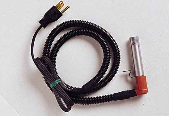

    Did anybody on this thread figure out more about the oem block heater and the recall and what not?
    I purchased a block heater oem from an Toyota dealer that has a parts store on eBay. And it was only 202 watts. And supposedly he was saying this is cause of the recall and they don’t offer the 400 watt anymore. Can anyone confirm or invalidate this?

    I appreciate the response anyways. Been trying to decide on wether I should just bite the bullet and install it or return it and keep looking. But I plugged it in just to see how well it would work and had no idea how fast and hot that thing got. It must get into the triple digits. I only had it plugged in for about less then a min and I couldn’t touch it for an hour or so until it cooled down. So I guess even though it’s 202 watts not 400 it still pumps some power. So I guess I’m just gunna install it and take some temp measurements with a laser temp gun and check the readings on my ultra gauge before plugging in and then again before starting and see if it’s worth using.
