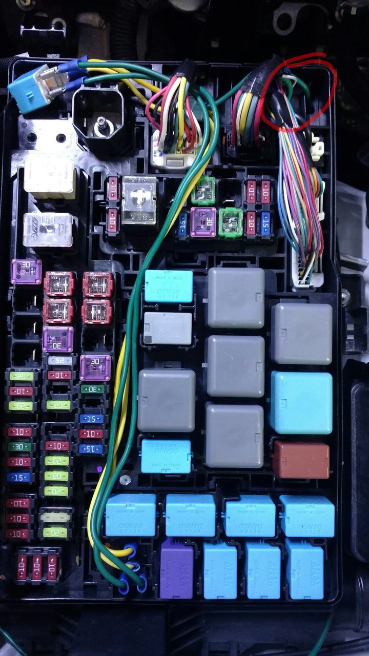

    I have been reading all of the threads on the anytime fog light mod. I just did my own....totally reversible and a go around for those of you that deal with inspections. This is for trucks that already have fog lights.
    The fog light relay has 4 pins. The two smaller silver ones send power to each fog light. The one in the middle loses power when you switch to high beam.
    All I had to do was to make 4 small jumper wires to relocate the fog light relay inside the under hood fuse/relay panel. The lid closes perfectly. There is a small knock out in the panel box in the rear corner....I drilled it out with a small drill bit big enough to run a wire through. I ran a green wire to the parking light supply wire (purple). I used a quick connect and ran the green wire to the wire already running to the middle pin on the relay. So when the high beams come the middle pin won't lose power. You have to have both wires running to the middle pin.
    The fog lights basically run anytime the parking lights are on....so you can run fogs with high and low beam at the same time.
    I ran the green wire (circled in red) coming from the parking light into the cab to a small toggle and run back to the relay. This way I can regain control of the fog light switch from inside the truck. (If you don't care about that, you can forget the toggle.)
    When you get your truck inspected turn off the black (unlabeled) toggle so the lights work as they are wired from the factory. Drive off and flip your switch to go back to "anytime mode"
    Best thing is you can put everything back in like 1 minute without messing anything up. I hope the info helps someone.

    so after you add the wire tap to the fuse box you can no longer use the cover for the fuse box?

    My cover went back on with no problem.
