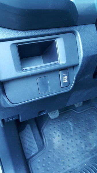

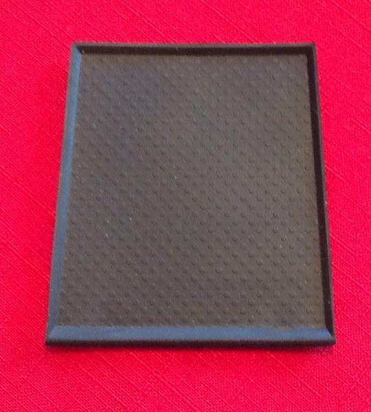

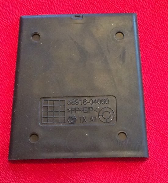

    Bring on the fog. Installed fog lights without too much of a problem. They work great and the lights that came in the kit are plenty bright. Would not have tried it without your instructions. Would never attempted to take out part of the dash.
    Small problem with the wiring harness. The ground wire and the wire that goes threw the firewall were on the right side. Easy fix by just pulling the pass threw wire out of the shield tube. The ground wire was only about 12" long and spliced in to the ground wire attached to the right fog light. Apparently whoever built the harness ran out of black wire. Also an easy fix by just connecting the ground wire to a bolt.
    While putting the lower dash panel back in place, a small 2" X3" flat rubber piece fell out. Could not see where it fell from. Picture (both sides) with a part number is attached. I put the dash panel back in place without the rubber piece.
    Thanks again for your help.

    The rubber piece goes in the cubby hole left of the steering wheel.

    I didn't even know I had one until it fell from the sky and landed on the floor of my truck. It does fit perfectly in the little cubby hole.

    Was looking at the post on LED fog lights and saw this picture you had posted. Looks like you had one at one time. It may have fallen out like mine as there is nothing to hold it in place other than gravity.image.jpg

    Son of a gun! I remember this picture and just went out and looked at the truck and it's not there. The thing is I never used that cubby or put anything in it so idk how it fell out......
