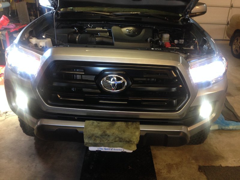

    OK Gang, I've Got FOG LIGHTS!!!
    First! Thank's for all the inputs!!
    It was, as usual, the simple problem that I thought I'd checked!! Bad ground 'cause I didn't prep the "grounding site"!! For those stuck with the harness that is wired for the ground on the passenger side there is a perfect spot about 8" under the radiator cap. An empty 10mm threaded hole (welded-on nut) ....... just make sure you properly sand-off the &^#$%@ paint!! That besides wasting three hours on non-problems and breaking one of my *#@*&$ High-$$ Hella yellow bulbs ... anyway... I haven't put the dash together yet as I was not in the mood to tackle getting the hood release cable re-attached and it was Miller Time ;-)
    1) I used the basic stuff that Moe2o4 suggested but I stuck with the light assemblies (& Blubs ..Now!!) and dash switch that came with the harness (I've got an AT).
    2) I didn't like leaving the cover off the fuse box so I:
    a) Heated up the cover, peeled off the fuse diagram and pasted on the back inside cover of the Owners manual.
    b) Drilled a hole in the cover over where the fuse is. Enlarged with a dremel tool. Replaced cover and then stuck the Add-a-fuse assembly through the hole into the fuse slot.
    3) I covered all the under the Hood wiring with additional, OEM like, plastic conduit.
    Maybe by Noon tomorrow I might have it all back together and be thinking about my next project ..... Dual Horns that sound like a Truck should.
    After that ... and warm weather ... it will be time to stick on the body trim mouldings and SS trim for the Grill!
    MERRY WEEKEND :)
    PS: The red lead on the relay is always hot!!!

    Sweet man, glad you got them working!!!!
