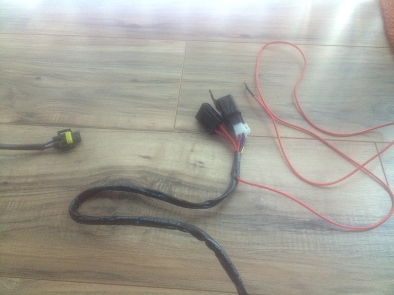

    Hello, I have a question about my wiring harness. On the passenger side harness there is a relay switch, something with a fuse in it, and a grounding wire. I've read in the previous post about the grounding wire but where do these other parts attach? Thanks for the help!

    The red wire (with fuse) is for the 12V positive power.

    I'm sorry, I'm not sure what that means. Is it correct to leave that on the passenger side or should it be rerouted somewhere else? I'm completely confused due to this harness being different from original instructions

    I think you meant that the red wire is attached to the positive side of the battery? And is there a good place to attach the relay? Thanks for any help anyone can provide.

    Also if the relay is alread attached to the harness then do i still need to add the ATC fuse adaptor? Thanks guys! I feel like a complete idiot trying to figure this out.

    I ran the red wire directly to the battery and mounted the relay on the inside of the fender support by the battery.
    I didn't tap into the fuse box at all.

    Thanks so much...Ive reread the directions about 20 times and have made sense of it all. I appreciate your reply and info on where to mount the relay. Im going to give the install a go this weekend!
