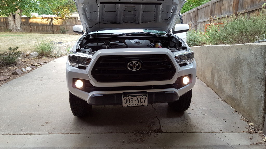

    I have fog lights! I also didnt need to take the dash off or remove the hood release.
