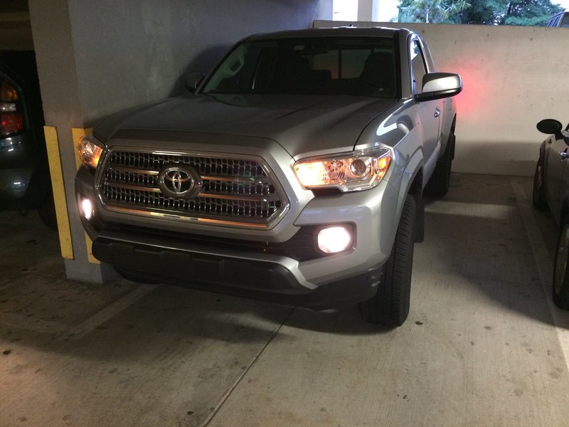

    I followed Bailey's suggestion with the pictures from OP and was able to easily install the new BD lights. I may need to make some adjustments but they definitely are brighter. We shall she how they work in the morning.
    I appreciate everyone's help.

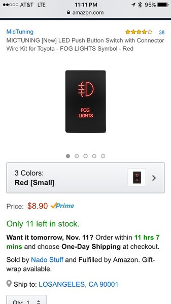

    Hello Moe! I too have a clutch switch on my SR and would like to purchase the same switch as yours. I've tried clicking on the link of your original eBay post but it no longer exists. Anyway you could lead me to where I can purchase that switch? Thanks!

    I just purchased this and hope it works next to the clutch start cancel switch. :)

    That switch will fit that location next to the clutch cancel switch!

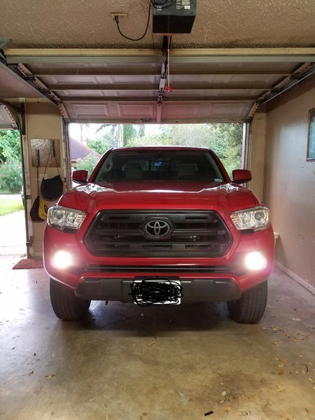

    I bought the Amazon kit. I forget which seller I got it from but they are located in FL. I bought Friday and they arrived today. I am very pleased with the quality of the kit. They fit my 2016 SR5 just fine but they are miss labeled L & R. I did put a bead of silicone around the outer edge of the glass
    I plugged them in to the oem harness. They are so much better than the 19 watt lame lights that the truck came with. I should have kept the lights from my 2014 that I added. Anyway thank you for this thread
