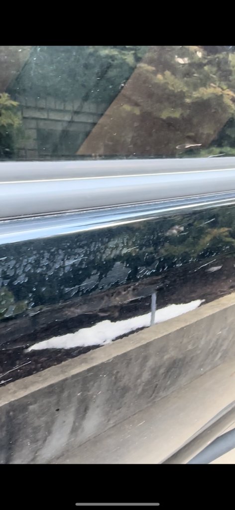

    Crazy they’re only doing this for white paint rather than acknowledging their clear coat is the issue. I’ve got a black 16 with similar issues under the windows and they refused to even bring it up to Toyota Canada
