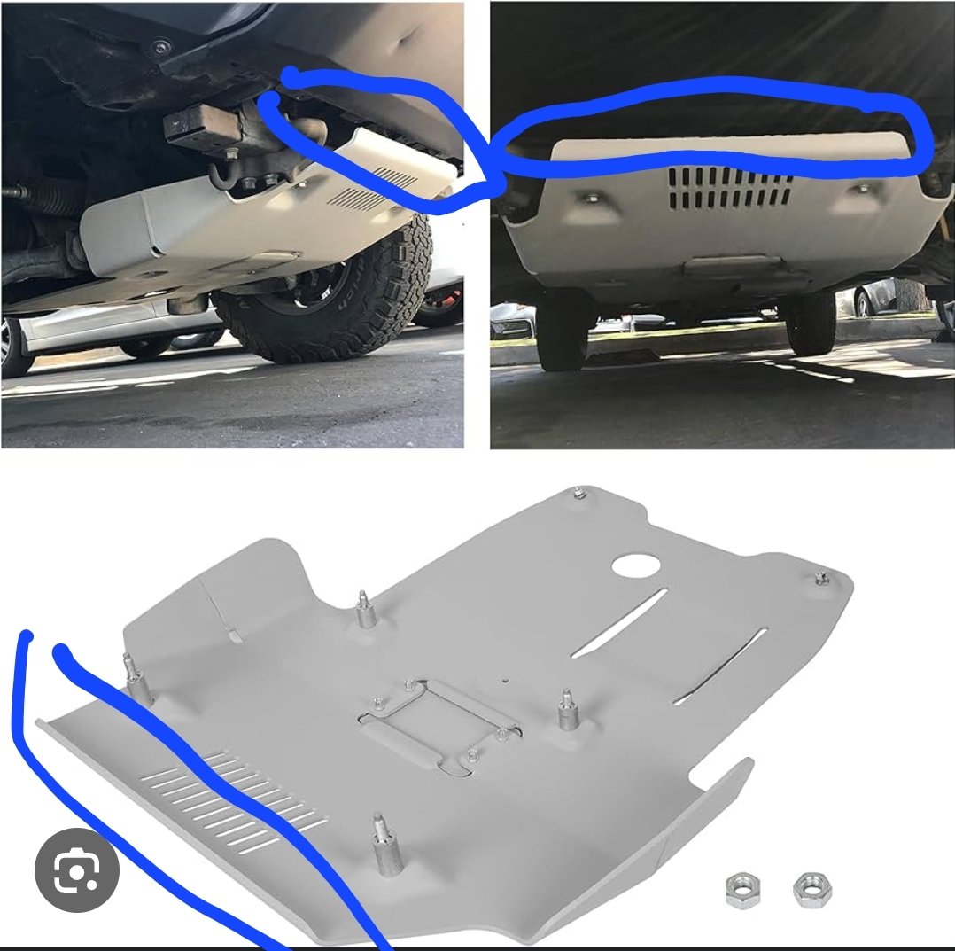

    Yes I did have to trim it a little as they disclose in the website listing. For clarification, you only need to trim the section that faces up at the front of the trd skid plate. That extra inch or so is what comes into contact with the bumper if not trimmed.

    So just to get on the same page and confirm really, this is the part youre refering to? Not a trd plate, but only pic i could find that showed what i interpreted as what you were saying.

    Yes, only the small section at the tip that bends upwards or vertically. I used a cordless hacksaw that cut it relatively straight then finished it off with a sander.
