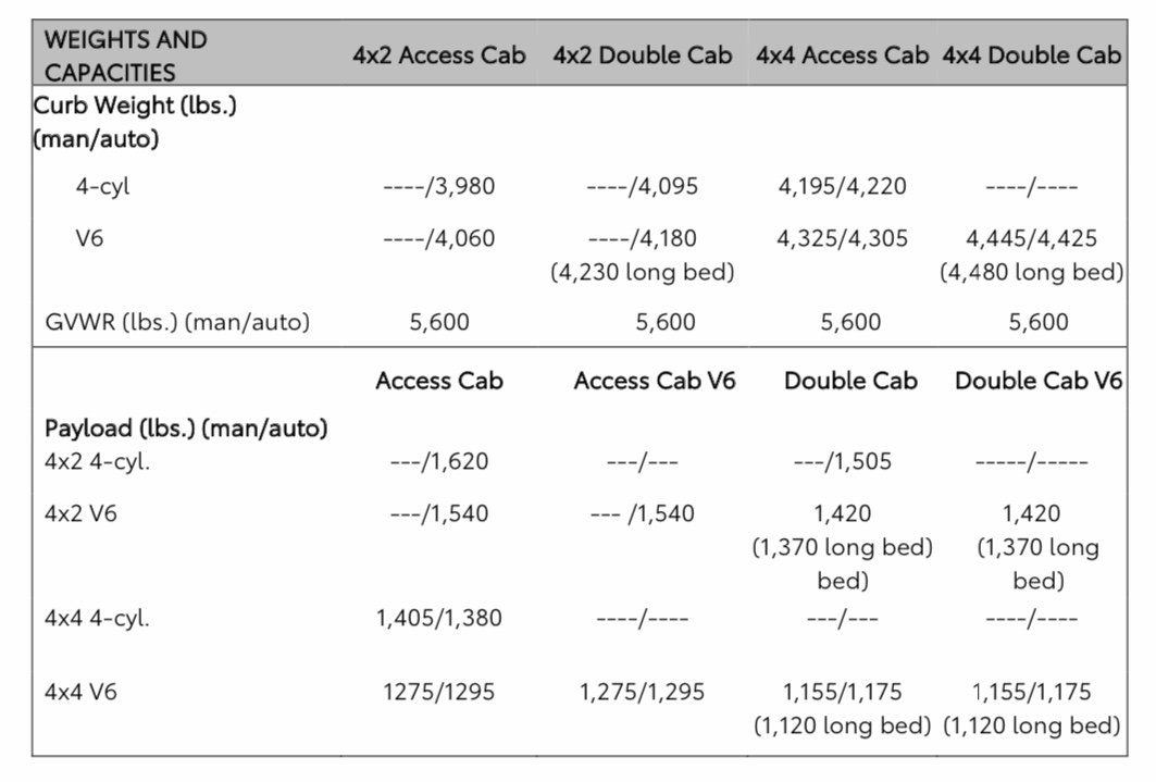

    Incorrect. I was off by only 780 lbs on the unloaded weight. I never claimed to have a perfect memory lol.

    Curious if your payload matches up? What is it? It should be at least 1601 if your truck is under 4k pounds.

    No my sticker payload is 1500 lbs, not 1620 lbs as in the chart. I’m certain everyone’s sticker payload is less than in the chart for their model. I suspect, but not certain that the difference is the factory tables payload is dry weight while the sticker payload includes fuel as most payload ratings appear to include, per google-fu.

    Payload is the difference of GVW (5600) and your trucks actual weight. So yours weighs 4100 fueled up. Math checks out if you do 20 gallons at 6 pounds per gallon.

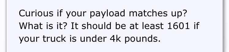

    Yes if you consider only 20 gallons, capacity is listed at 21.1 gallons.
    In any case what I was saying no to was your earlier post:
    The actual payload per my sticker is 1500 lbs not 1601. The 1500 lbs payload rating on the sticker includes fuel as I stated. It’s what you can carry when fueled up (fuel weight deducted from the dry curb weight rating in the tables).
    When I stated my Tacoma was the lightest of the models and posted the tables, the table curb weights appear to use the dry weights. It was for comparison of the models weights.
