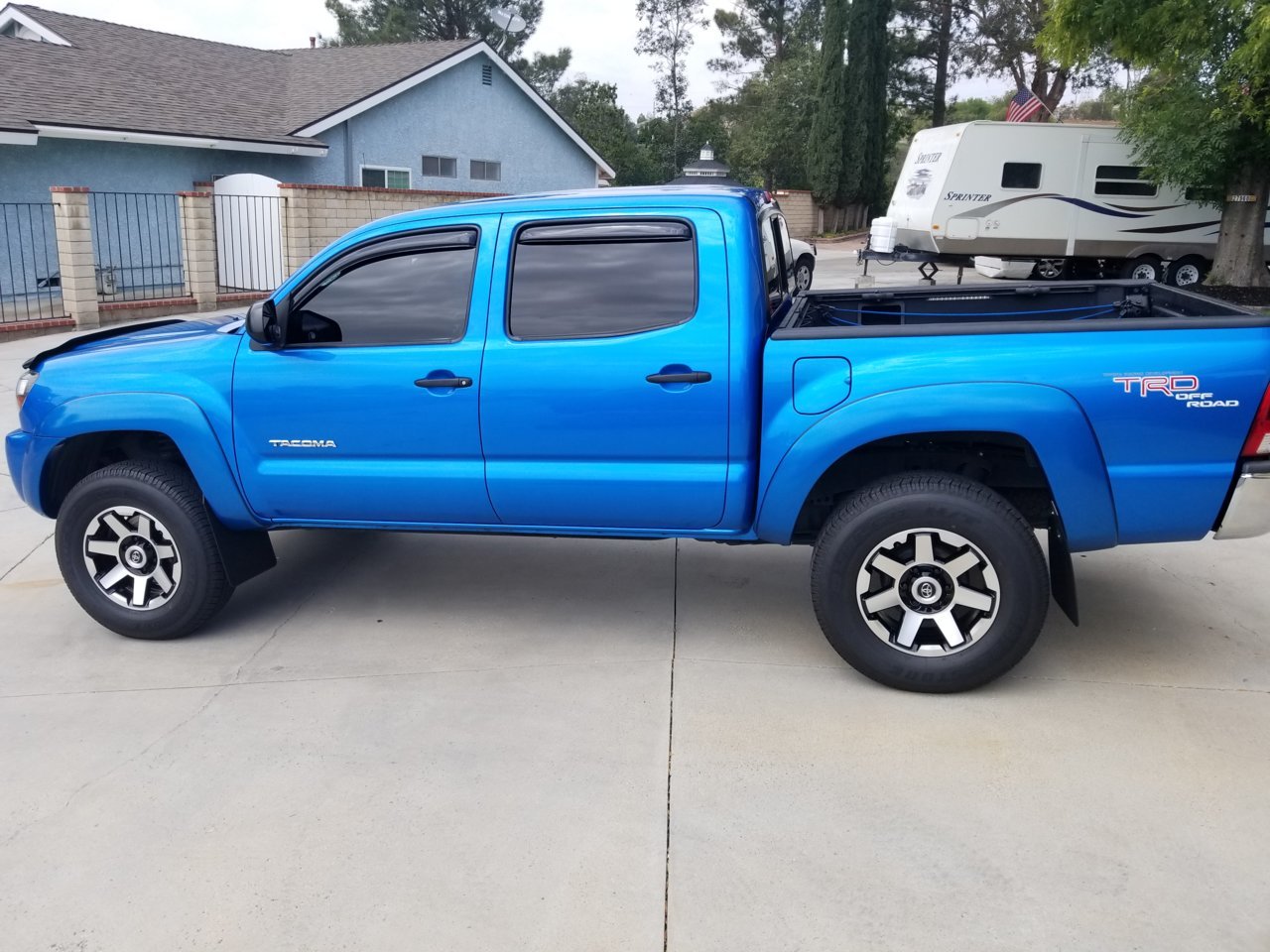

    I got 265/65/17 nitro terra grapplers. Someday 5100 with 270s and maybe thought about color matching the wheels maybe we’ll see

    Looks sexy on blue .... try yanking the center caps!

    I agree. Black lugs just added. I was thinking of painting the caps black so they don't stand out as much.

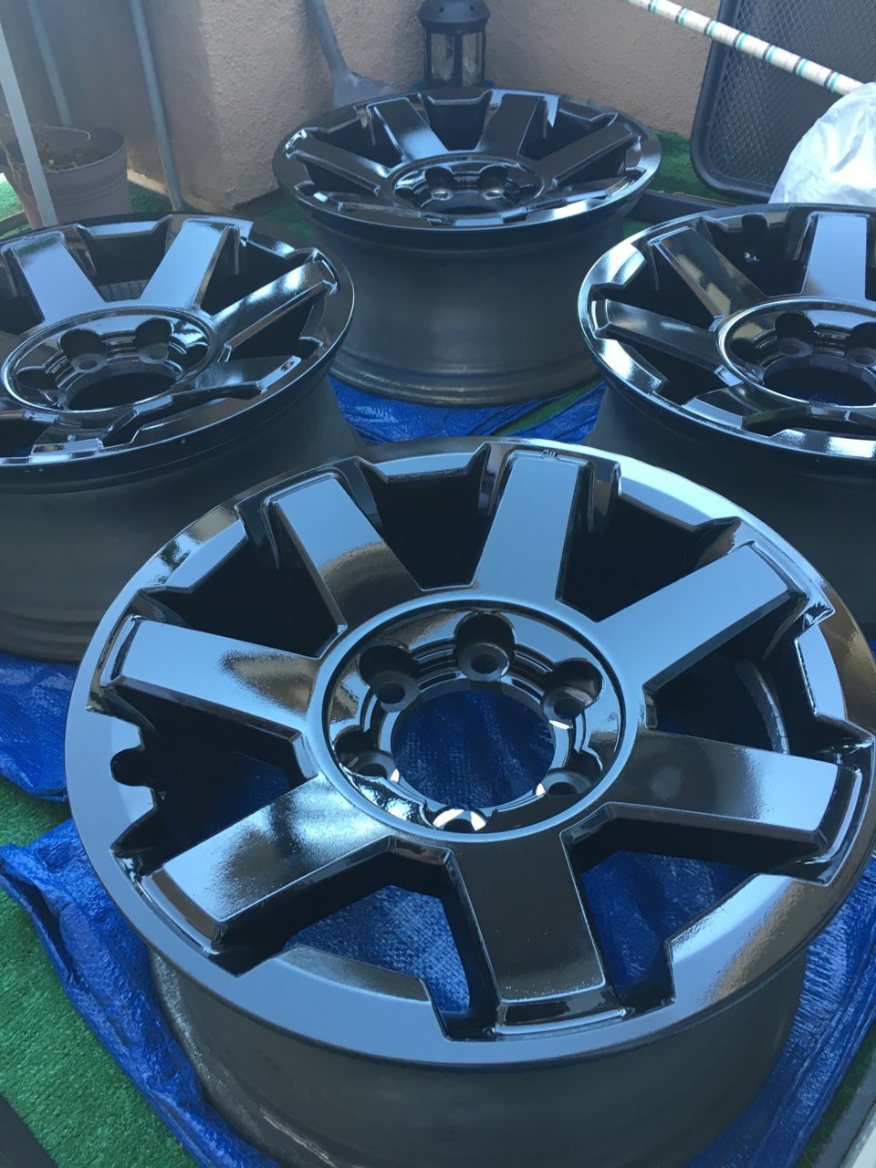

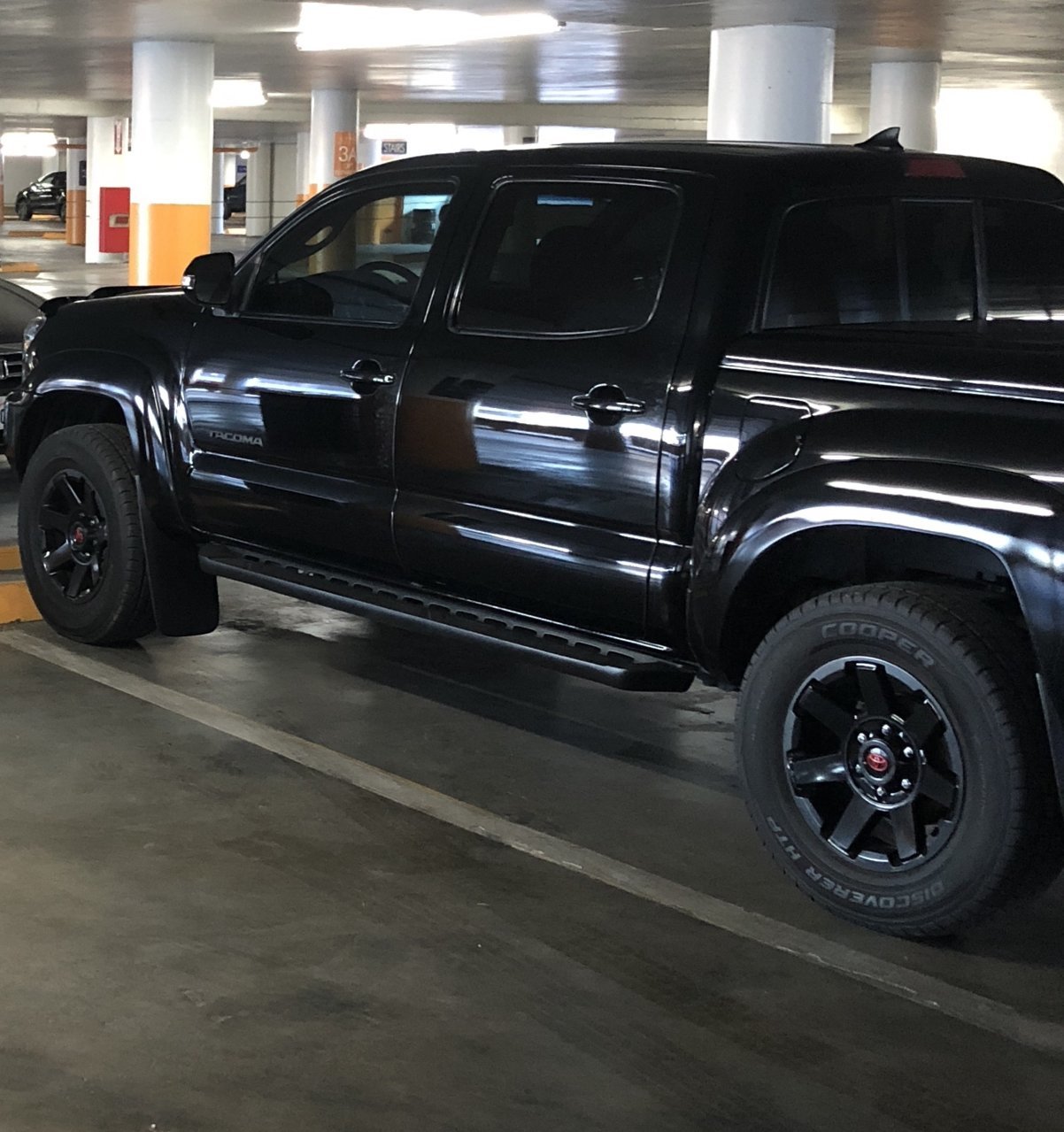

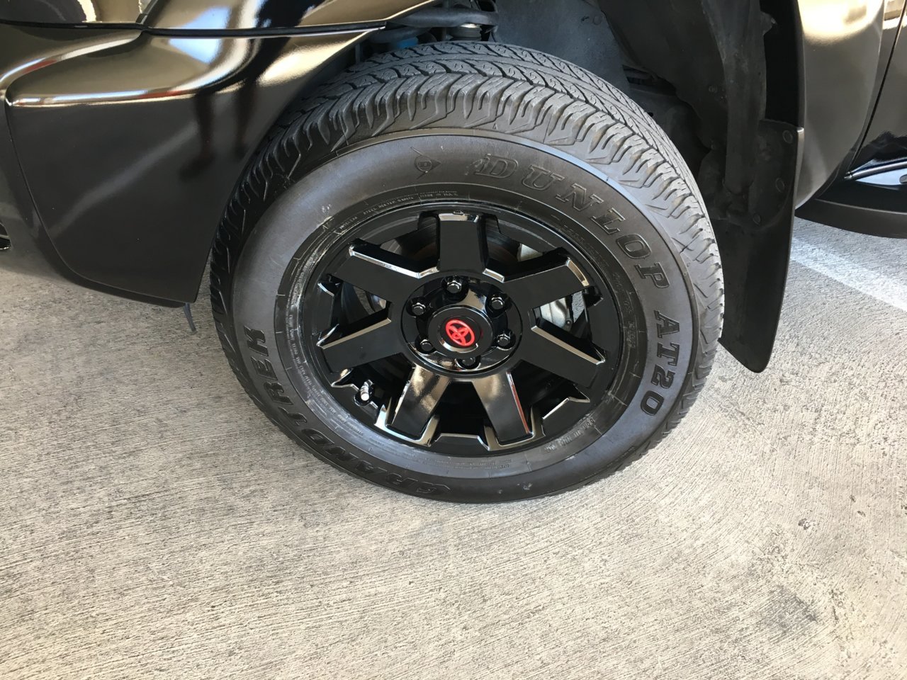

    I painted mine black with duplicolor wheel paint and gloss clear coat. Still looks good after a year.921D526B-B02E-4B55-8AEA-C0EADDA860D1.jpg
    Now with new Cooper tires

    Hi, looks good on blue! Did you buy those black mag seat lugs?

    @DirtJumper14 few questions: how many coats of the wheel paint did you put on? What type of prep did you have to do and did they get messed up when you had tires installed?

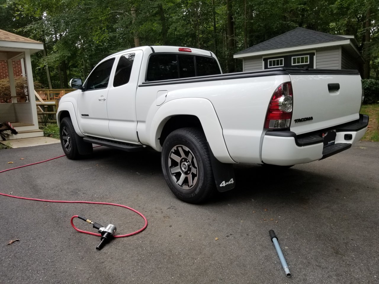

    I’m running the trail wheels too.
    What about the spare 16” wheel which is now about 1 inch less in diameter?
    Anyone replace their spare with a 17” wheel or a bigger tire on the 16” steel spare to get to 31.6” diameter?

    Hi Sir,
    It was my first time to paint rims so I “Googled” and watched a lot of “youtube” vids before attempting to paint it;
    -washed the rims with Dawn dish soap, rinse then air dry.
    -used Scotch Brite scouring pad to make the surface a little rough. Then washed and air dry.
    -used 2 coats of Duplicolor sandable primer. Then let it dry for a day.
    -the following day, I did wet sanding to smooth out some rough spots made by the primer.
    -used 4 coats (per wheel)of the Duplicolor wheel paint. Followed instructions on the can on how to time interval between coats.
    -Used 2 coats of Duplicolor Gloss Clear Coat (for wheels). Follow instructions on the can on the interval between coats.
    I waited for a week for the paint to harden. When I brought it to a local Discount tire, the tech messed up a tiny spot on the edge on one of the wheels. I asked him to be careful on the next 3 wheels since I told them that it was recently painted.
    I hope this helps you sir. It’s been a year and the paint still looks good. I just need black lugs since the OEM lugs that I painted has started to chip.

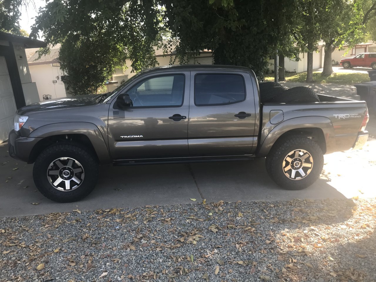

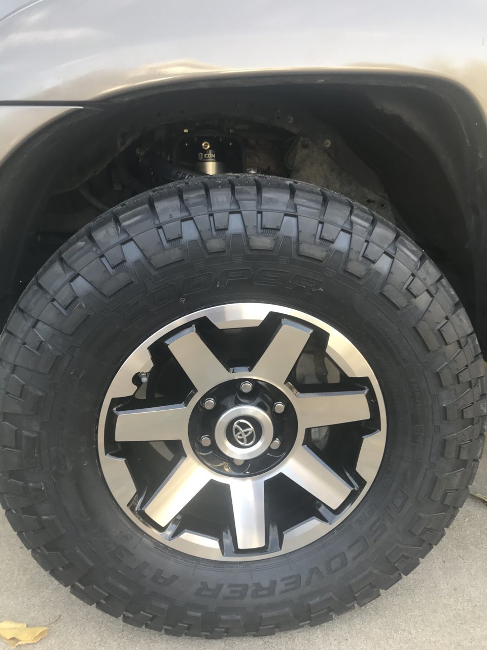

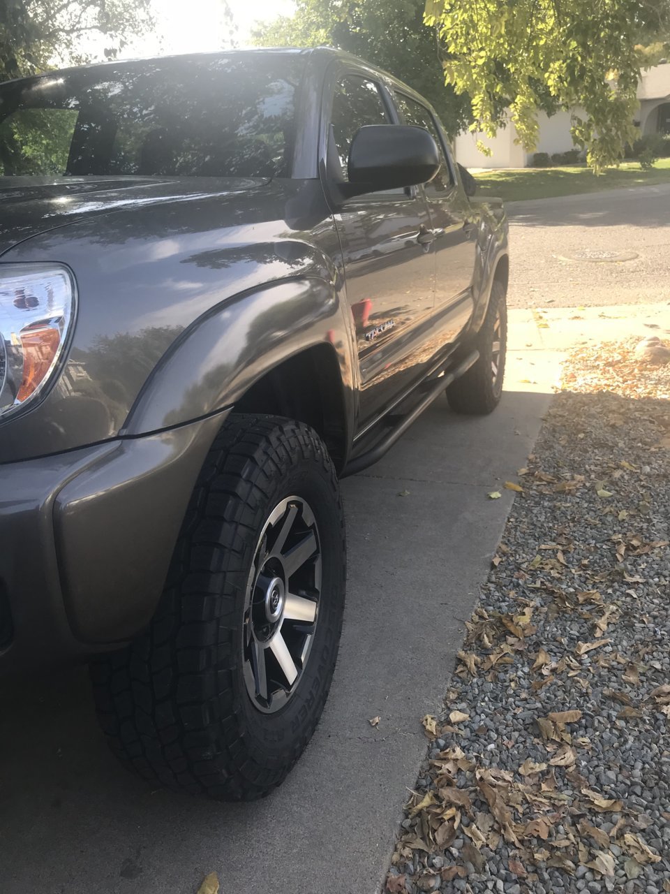

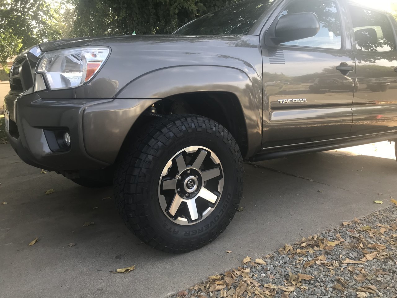

    Got mine installed today. Love the way the turned out. Went with cooper XLTs in a 285/70/17 flavor

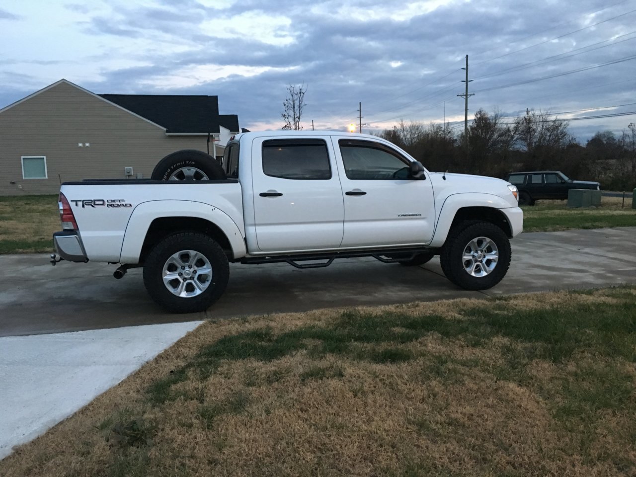

    Got the sr5 wheels with 275/70r17 falken at3w’s28C330A5-15CA-42E1-B548-CBD2F16F8BA5.jpgB6145562-040F-46AA-96EB-62434915F9C6.jpg

    Do you rub at all?

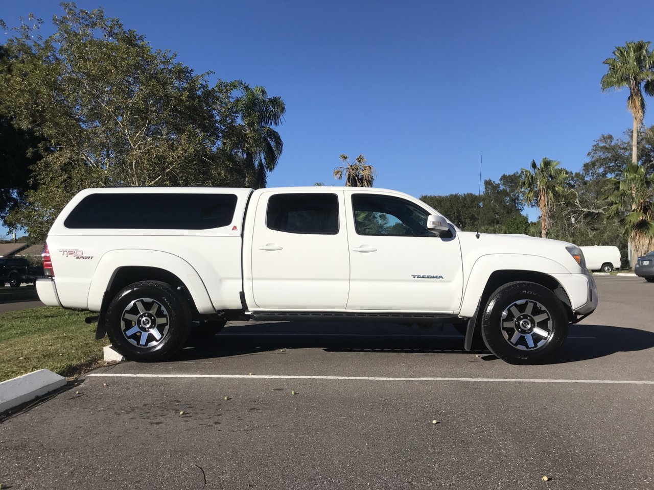

    2012 Tacoma TRD Sport White DCLB

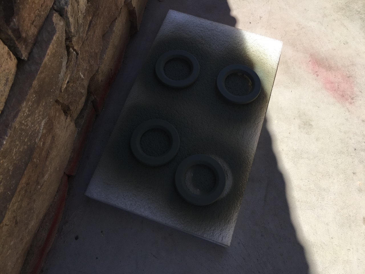

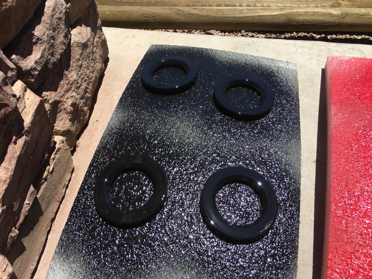

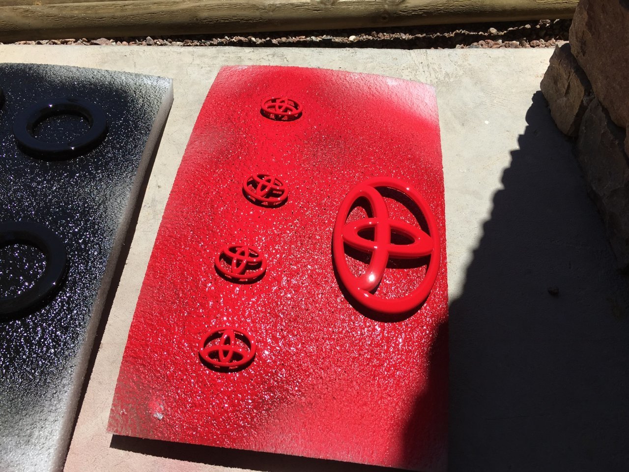

    Center caps for wheels LEER 100XQ topper
    3608C916-9D6C-475C-8C48-355BC1507FBA.jpg 6DE63F8E-FF64-45C2-BD59-4A108C045193.jpg 8BA5A341-C50F-453A-A827-6D7A7E9BD08F.jpg
    Stock suspension. 265/70/17 Tires.
