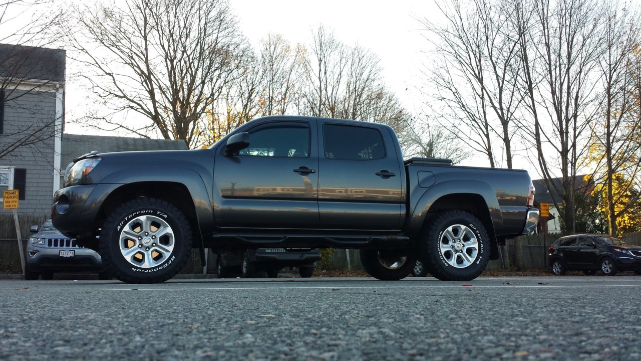

    I installed this suspension in 2009, 2 months after purchasing the truck. I have loved the ride and the look.
    At 65000 miles alignment cams and tabs seized in lower control arm... replaced both lca's and decided to refresh suspension.
    Eibach 620 springs up front, Ome add a leaf in rear and Bilstein shocks set at 0 all around. Suspension installed in July.
    BFG KO2 265/70/17 and SR5 wheels installed November.

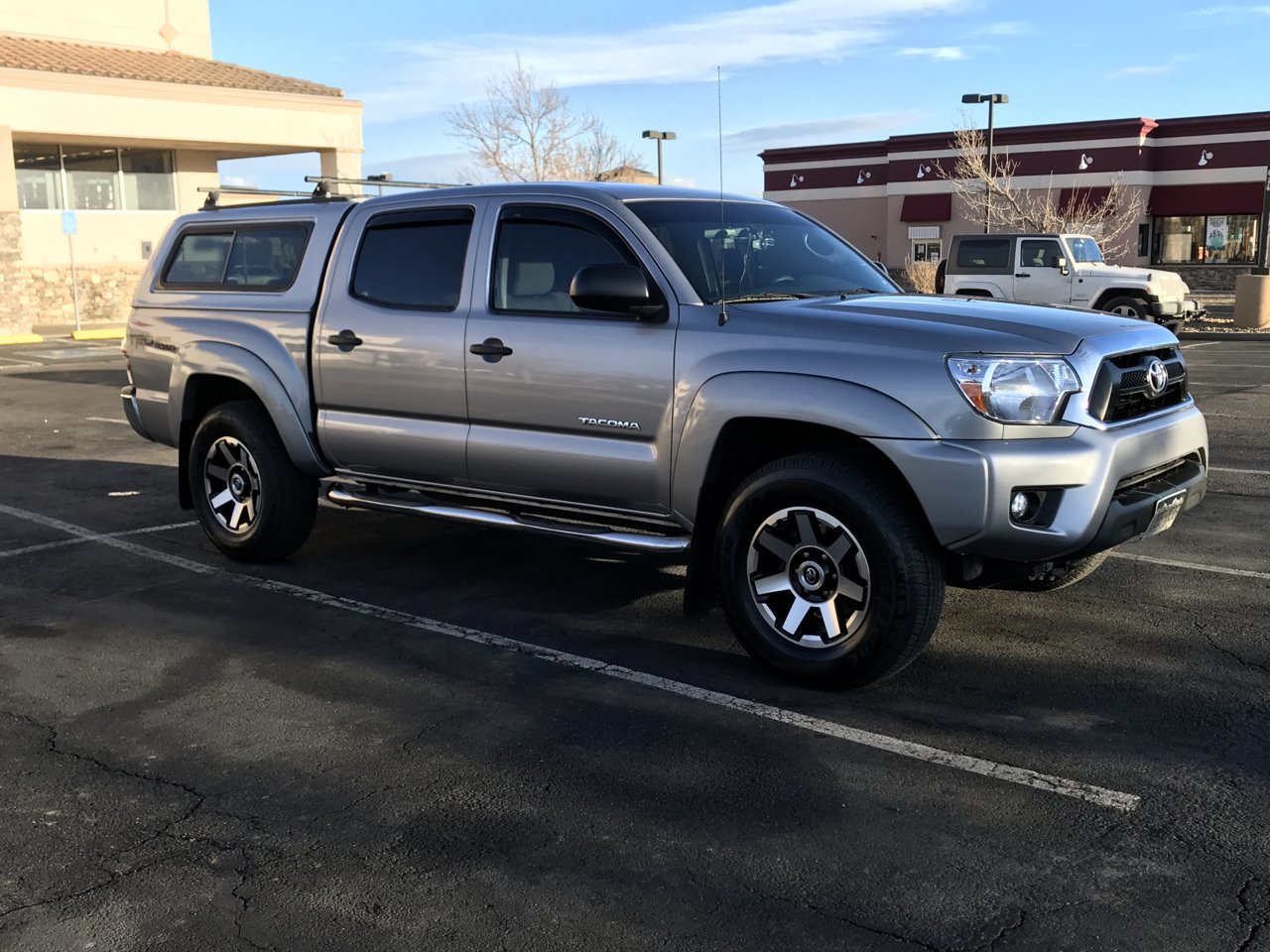

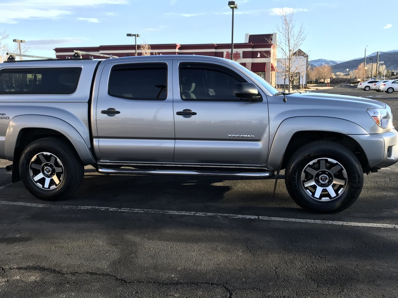

    I just picked up a set on craigslist for $550 brand new take offs that still had the rubber nipples all over the tread and got them installed. Stock suspension, stock everything. No rubbing from what i can tell. Big o tires did the tpms sensor switch from my current trd off road tires for $37 total, basically just charged for the stem repair kit. My only beef was that they were careless with their air wrench and chunked up the area surrounding the stem a bit on all 4 wheels -_-
    But still love the look so far

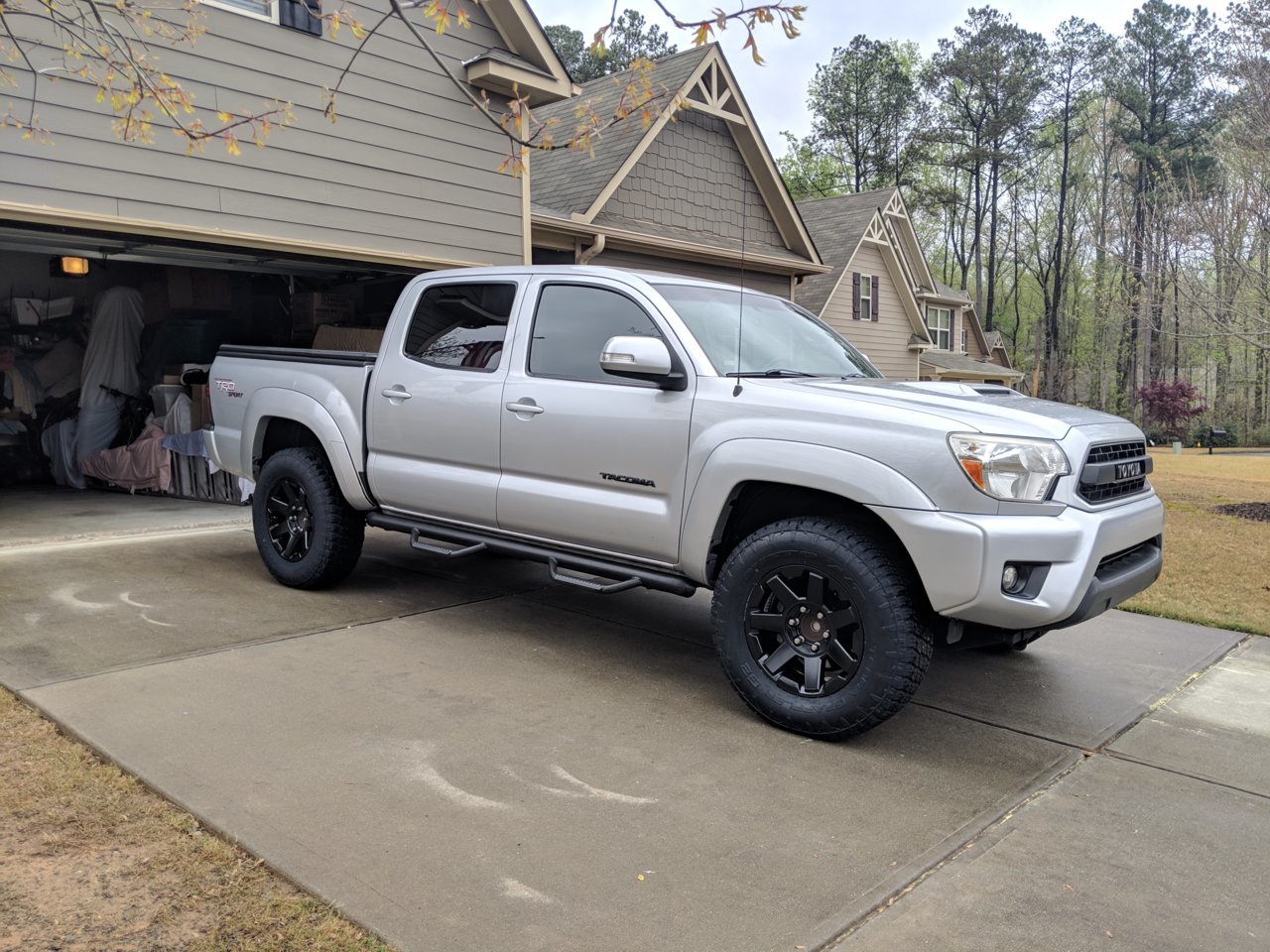

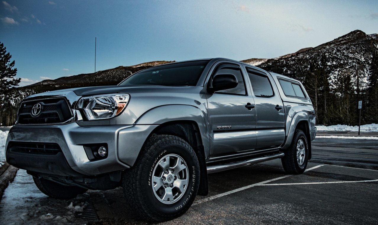

    Here’s a shot of her wit the stock trd off road 16s before the switch

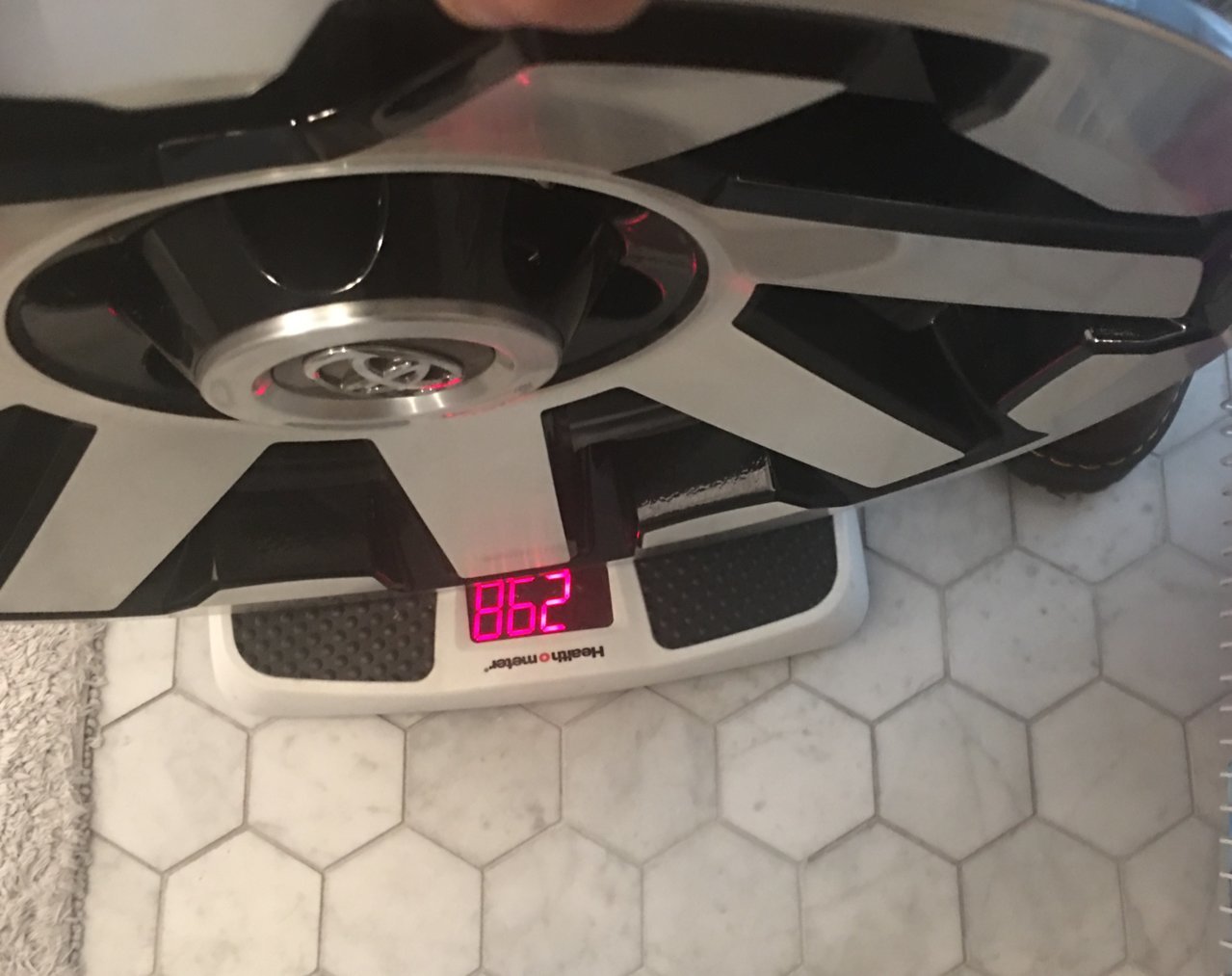

    I picked up a 5th rim for a spare and decided to weigh it on the scale. Just for everyone’s info.

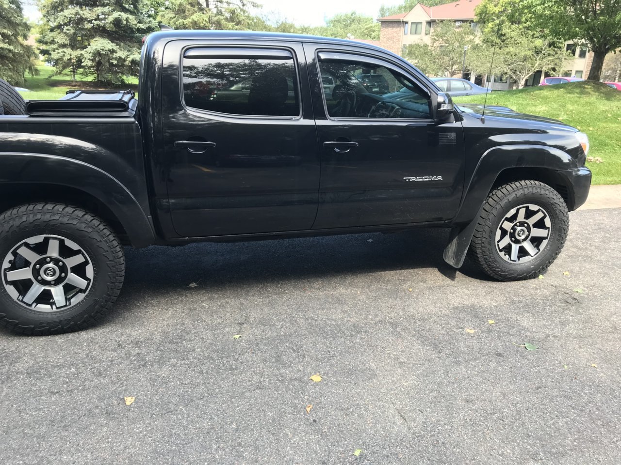

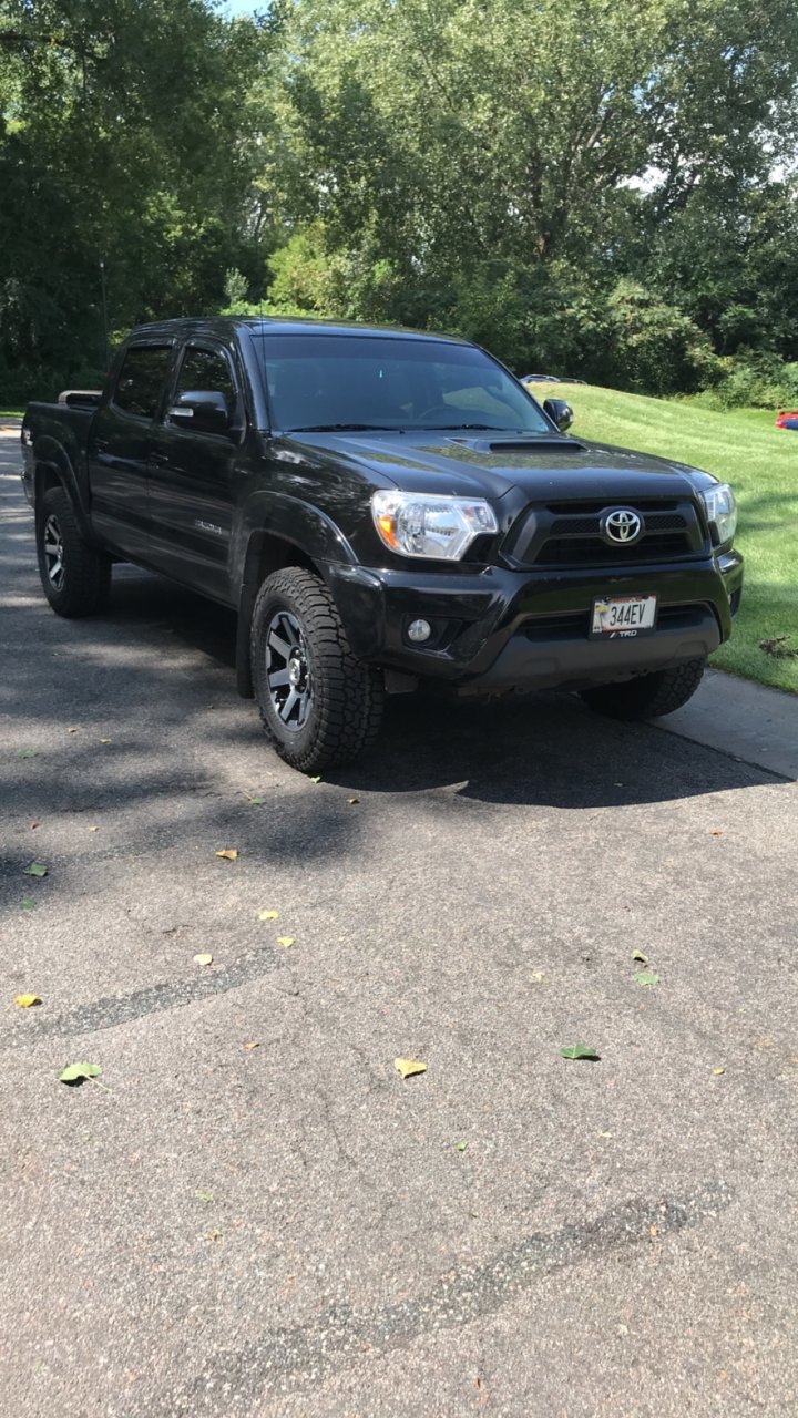

    This thread inspired me! Picked up a set of rims for $300 on Craigslist and just got some new 265/70 wildpeaks mounted up today. No rubbing issues!

    nice! Looking into these rims right now on fb martketplace. I like this set up!
    did you have to run spacers? Or this is stock? Cause the stance is nice!

    Looks good! This is pretty much the same set up I will have! What tires are those?

    the backspacing is 4.75 i think so no need. No spacers on mine and i have 275/70 wild peaks and i only barely rub at full lock in reverse but i have the 887/5100 lift, I haven’t done any trimming but it’s prob minimal when i do it.
    887/5100 lift + aal13E752C6-5722-484B-851C-4A1868E856CC.jpg Before that i ran the 265s stock 4Runner Bridgestone dueller h/ts with 3rd gen front sus(1in lift) and zero rub.
    3rd gen lift
