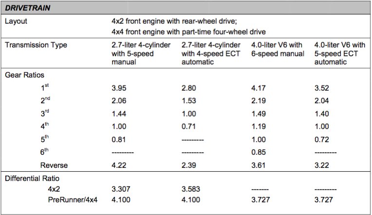

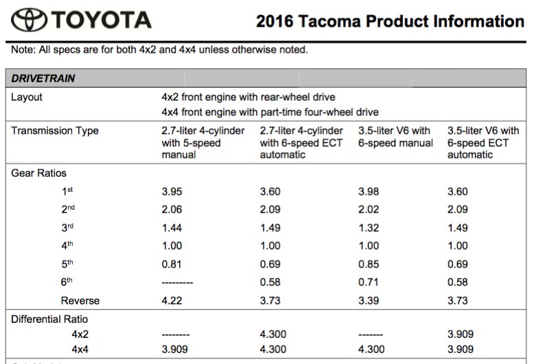

  14. Apr 25, 2016 at 8:33 AM
    #254
    TacoSeattle
    TacoSeattle Well-Known Member
    Oct 26, 2015
    #167806
    264
    2016 Tacoma TRD OR 4x4 v6 SB Quicksand
    Here are the gear ratio charts for the Gen 2 and Gen 3 Tacomas. 5th gear results in about the same final drive ratio on both trucks: 2.683 vs 2.697 which means that the cruise rpm at a given speed is about the same. The 3.5 liter engine has slightly less torque than the previous 4 liter so it would generally tend to shift sooner back from 6th into 5th where it cruises about the same rpm. I find that in my configuration of stock size tires and a bed canopy, that overall it does drop to 5th easily on an upgrade or head wind and then back to 6th on the down slope. Cruising at 65-70 results in less shifting then at 75 mph probably because of the increase in aerodynamic drag which is a square of the velocity. Lifts and bigger tires will make it more "shifty" because of the increased energy requirements. Just my opinion.
