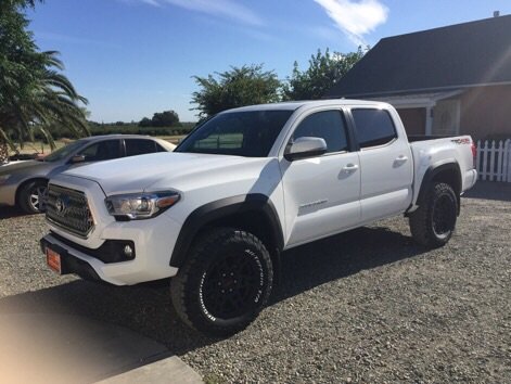

  20. Jul 10, 2016 at 4:29 PM
    #380
    Tacohotshot
    Tacohotshot Well-Known Member
    Feb 22, 2016
    #179096
    137
    Gee look I have a truck
    ZachMX likes this.
