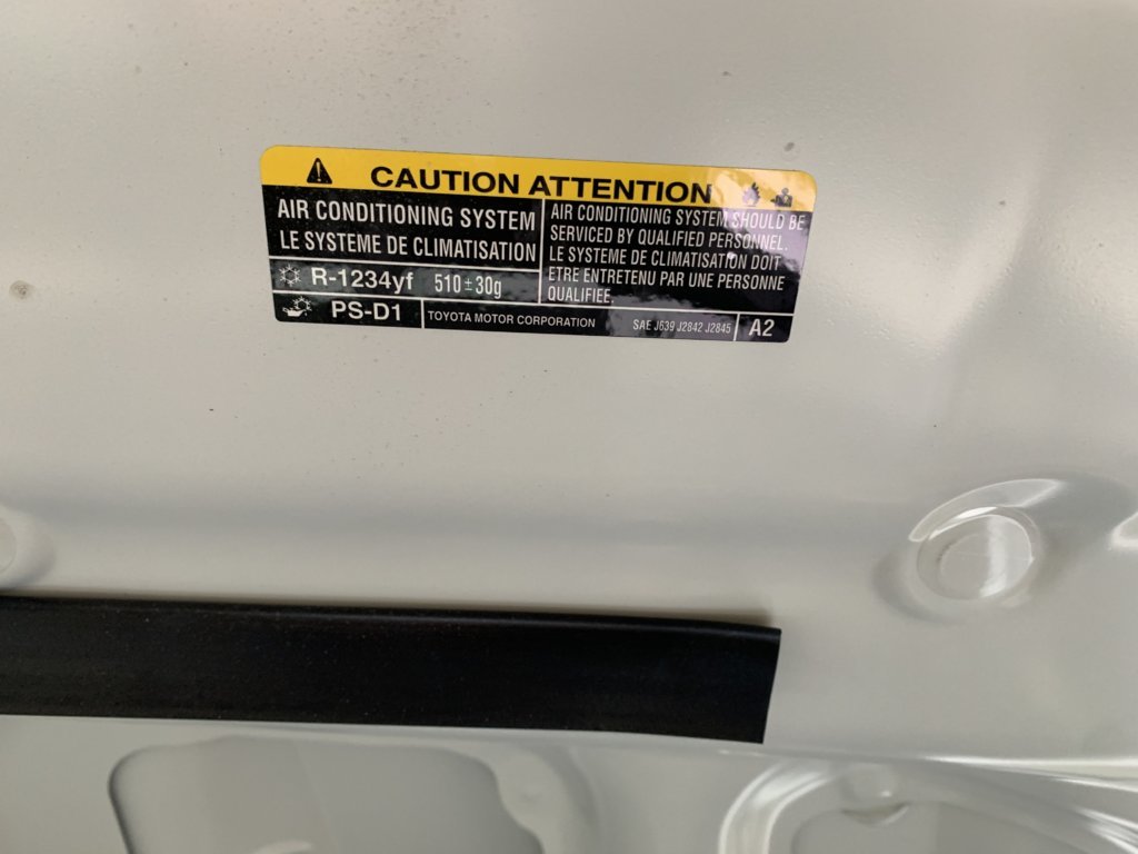

    Assembled in Texas your vin starts with a 5. Assembled in Mexico your vin starts with a 3. My Texas assembled Tacoma uses R1234yf.
