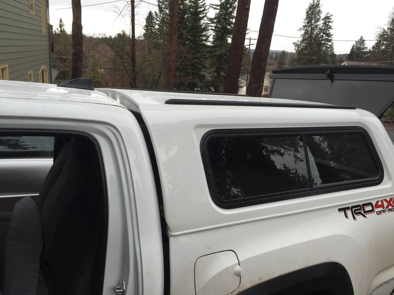

    Pockets - From this angle (which could be misleading) it definitely looks like the upper edge of the canopy sits above the shark fin antenna base. Just for fun, go to the Show Me Your Shell thread, page 202, "Lost Sherpa", number 4032. This photo of a CX from his angle shows that the top of the canopy is definitely lower than the shark fin base - which would be correct. Angles and photos can be in error but it looks different in Sherpa's post.

    Made me dig for it. Anyway, certainly looks like @pocketsmcaaron's sits higher , at least from the angle of the photo. I really hope they get it sorted out.

    Thanks Taco, it appears that from pg.202 his shell rests lower than mine. In my first post, I mentioned my previous ARE CX for my 2nd gen worked good and I experienced no loss in Mpg. Camera angles are tricky and are different, but my shell on the top in fact encroaches above the cab's roofline, which creates a parachute effect especially when I go above 50mph. I also noticed I get a lot more rain hitting the front inner window of the canopy, this did not happen nearly as bad on my 2nd gen CX set-up.
    ARE's response: "I do apologize you are unhappy with the fit of your recently purchased CX series cap. The area of concern is not a design flaw after carefully reviewing your photos as well as looking at our 2016 Tacoma with a CX cap with my engineering team. We believe your cap is fitting as intended. If we were to match the cap up with the lowest point( at the rear) it would appear almost a "V" shape which would be less aesthetically pleasing, and may be more problematic. If you are truly unhappy with the fit/appearance of your cap you will need to address it and continue to work with your original dealer, since that is your point of purchase."

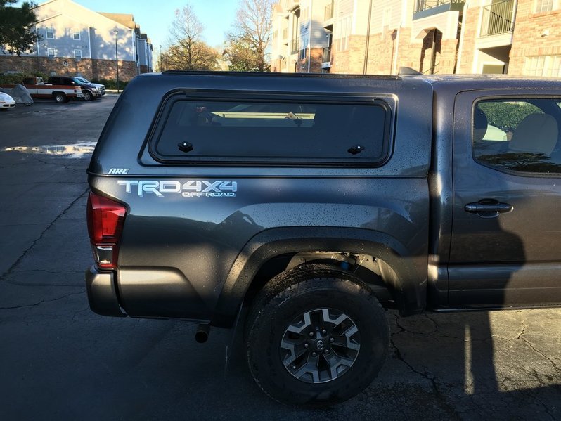

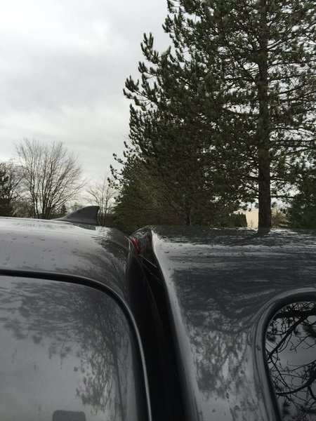

    I have the CX as well and my MPG haven't suffered at all... I have read different dealers use different foam seals between the topper and the bed that may cause varying degrees of height.

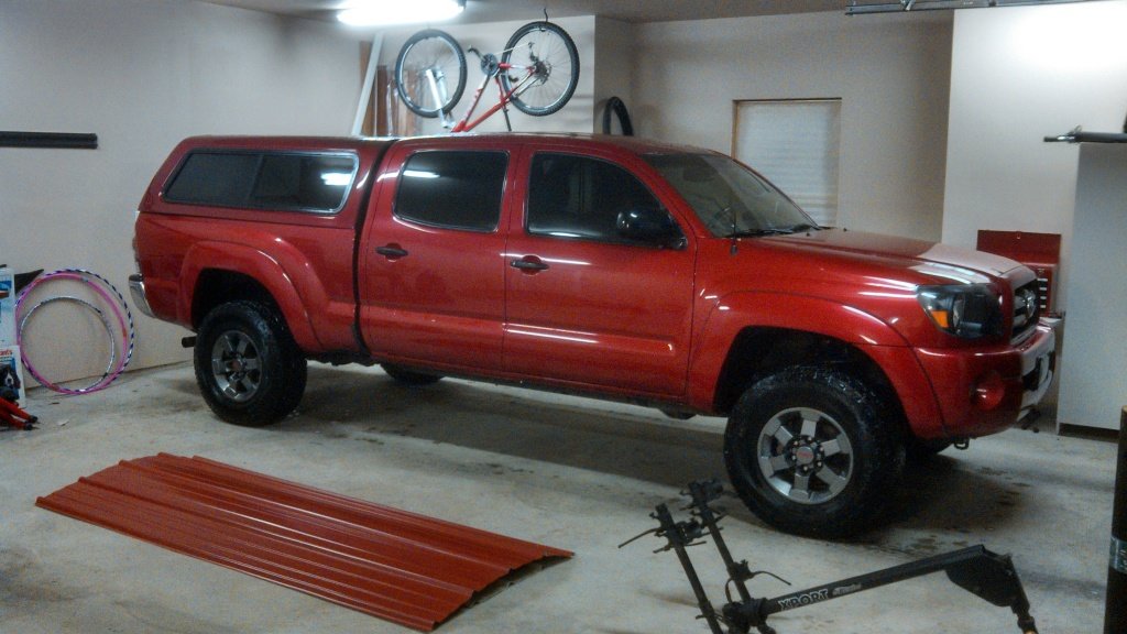

    I assume the "V" they are talking about is the rear of the cab coming down and the canopy/topper matching. This seems pretty standard. Pic of my 2nd Gen. 3rd Gen should be similar.

    Profile.

    My second gen sat the same way from cab to canopy, Dexter. My 3rd gen did not.

    Lost, If my CX articulated lower than the base of the attenna, as your picture shows, I wouldn't have had a problem. Unfortunately, the top rested above cab's top ridge-line

    Maybe they can try a different seal? Seems to me like if it measures the same then there has to be an actual fix.

    And you think it would since the cab design didn't really change that much. ARE said the V would be unappealing yet that is how the 2nd Gens are.
