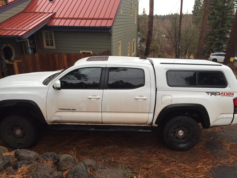

  10. Jan 22, 2016 at 7:58 PM
    #50
    pocketsmcaaron
    pocketsmcaaron [OP] Well-Known Member
    Sep 7, 2014
    #137756
    350
    Oregon
    '16 OR MT DCSB WHT Prior:'15 MT ,'94 MT
    Snugtop Rebel,TRD Pro Bilsteins,2" Block rear,SR Grill,TRD Beadlocks,Toyo AT 2s,Focal Experts,Kicker AmP & 10" Sub
    image.jpg picture was taken last Tuesday
