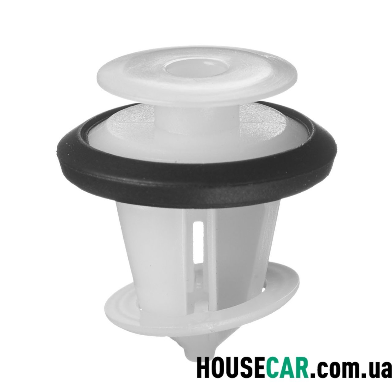

    Taking the panel off is no big problem. As you look at the open door, where the door meets
    the front door, there is a "push clip" (11 o'clock on the passenger side and 1 o'clock on the driver's side) kinda looks like a little black bulls eye. Simply push the center of that pin in a
    little and gently pull the pin out(you will see a slightly larger ring around the pin you just
    pushed in, that is what you are going to take out. Remember to push the center back out
    when reinstalling it later
    . Next, remove the two screws, one in the grip just below the
    window and the other is behind a little "beauty" patch in the handle you use to open the
    door with (I think you will need a T-25 Torx driver to get them out). That "beauty" patch
    is hinged at the front so you can open it with your fingernail or a small screw driver. At
    the bottom of the door is the lower seatbelt anchor, you will remove that with a 14MM
    socket. If you have any trim tools, here's where they will come into play. If not, simply
    wrap some electrical tape around a narrow putty knife and slide it between the bottom
    of the door panel and the metal door. Work your way along the bottom of the door until
    you meet some resistance, then pull the panel towards you. In the bottom center of the
    panel are two plastic pieces that align in two holes in the metal door. Remember these
    when you put the panel back on the door.
    Once you have the bottom loose, pull the
    forward weatherstripping off the door and set it aside. Before you do anything else, look
    in the gap you just created, using a flashlight. Notice the plastic hooks (they actually look
    like "U"). When you are putting the panel back on, make sure those clips are free (I keep buggering up the one at the handle) and go between the weatherstripping and the metal
    door during reassembly - they are what hold the front of the panel to the door.
    There are
    10 red plastic clips holding the panel in place. When all clips are free, the panel will be
    hanging at the top of the door. Before you remove the panel, study the slide assembly
    for the seatbelt at the top of the door. Note that there is a bolt & nut that fit into that
    slide assembly when things go back together. I did not remove the top seatbelt anchor,
    but chose to let the panel rest on an old blanket on the ground. With the panel on the
    ground, count the round red clips and make sure all ten are in the panel. If not you may
    have one or more still in the door remove them and place them back on the panel. Replacement is fairly easy as the mounts they go into have an opening on one side
    that the clip slides into. In the lower half of the door you will see inner door covered by
    a plastic (PET) panel which easily comes off and on. Reassembly is just as easy as disassembly! Save yourself some time and frustration by cutting squares of painter's
    tape and placing them on the outside of the panel where the clips are - you'll know
    where to pop the panel to reseat the clips. Now simply begin by hanging the panel
    on the top of the door and lining up the two plastic pieces at the bottom with the holes
    at the bottom of the door. STOP! Check the alignment of the seatbelt slide assembly
    at the top of the door. Ensure it works correctly. Remember those U clips along the
    front of the panel? Ensure none are bent or out of alignment (my headache was the
    one at the door handle assembly. When everything lines uop, go back to the bottom
    of the panel and start popping those clips back in place. When the door is back together,
    don't shut it yet. Operate the door handle and ensure there is no resistance and that
    the locking mechanism works, try the seabelt height adjustment and see that it works correctly. Button things up and stick a fork in it, you're done!

    I attached an image of the new fastener that was supplied by the dealer. They are different from the red clips installed at the factory.

    Those white clips look like the ones on the front door. For the access doors I used these off of Amazon: https://www.amazon.com/gp/product/B07R1QTSQ1/ref=ppx_yo_dt_b_search_asin_title?ie=UTF8&psc=1
    They look and fit like the OEM ones and also work for the rear wall panels. The OEM red clips break easily so having spares is a must. Not uncommon for them to be damaged from the factory.
    I wish I had seen wudbuchr's post months ago. I ran into the exact same snags he warns about. The FSM doesn't mention them at all.

    Wow! Thanks for that link. Just ordered and really appreciate you sharing. Now I gotta figure out what’s causing the rattle and put it all back together. Thanks again.
