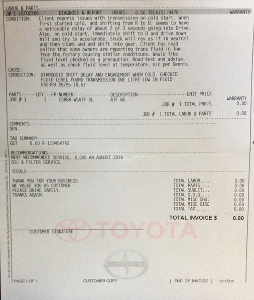

    Here's the service record from getting mine checked and filled. Not sure about the actual time, but they billed 0.5 hours for me.
    Did it no charge under warranty. I wasn't experiencing any major issues, I just wanted it done as a precaution and it was 1 liter low. Definitely feels better afterwards, much smoother shifts.
