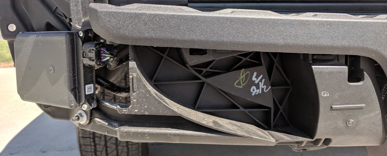

    The BSM connector is on the sensor assembly itself, which is about the size of a deck of cards. I think the bumper cover has to come off to access them with any sort of ability to work on them. It's all one piece as far as I know. The park assist uses 4 small round ultrasonic (I think) sensors which are on the outside of the bumper. The two BSM sensors are under the bumper cover in the corners and work on some sort of radar like EMR.

    Can I see the bsm sensors without taking out the bumper covers. I just check my truck and the only sensors I am seeing is the four sensors on the rear bumper. I am a bit confused

    I think your pic explains it just had a closer look.
