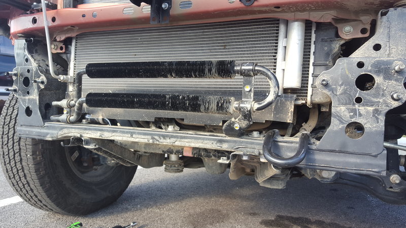

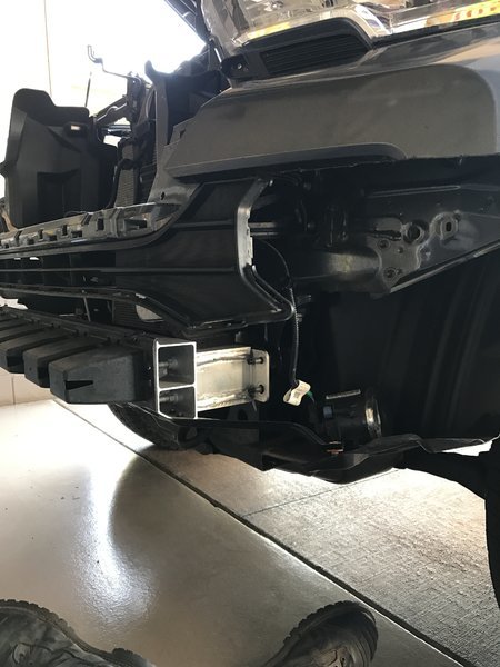

    14795824406611677076545.jpg 1479582457200495454225.jpg okay having some issues which ones are the steering cooler relocation brackets? I assume the ones with 2 holess but not sure
  2. Nov 19, 2016 at 11:34 AM
    #42
    mauidogg
    mauidogg Well-Known Member
    Dec 28, 2015
    #173272
    508
    16 DCSB TRDOR
    Yes. The on with 2 holes

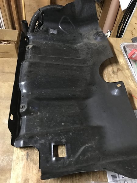

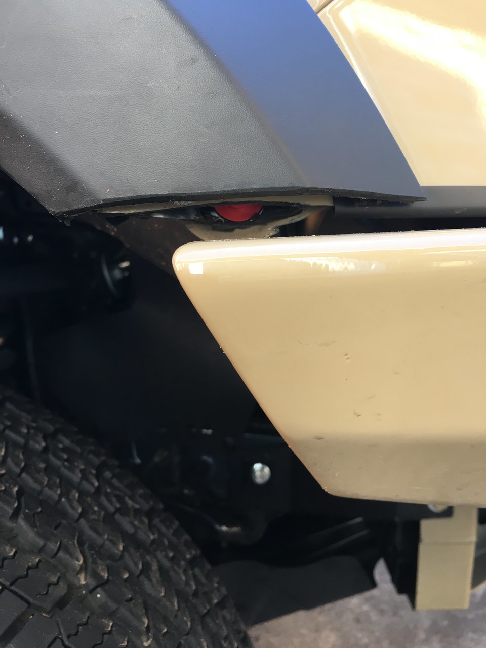

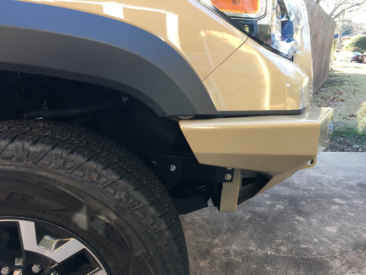

    did anyone have to guide off this loop?

    The reason why CBI and other companies want you to cut 1/4 inch above the bumper and have a gap is because the bumper and the body will flex differently. If your bumper flexs upward into the fender and the gap doesn't exist you could shift or damage the fender/body.

    I didn't cut it. I took a BFH and beat it into submission.

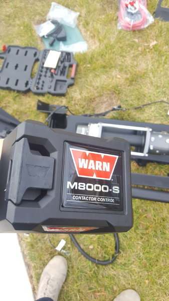

    Anyone have a good place to install the winch controller on this T3 bumper?

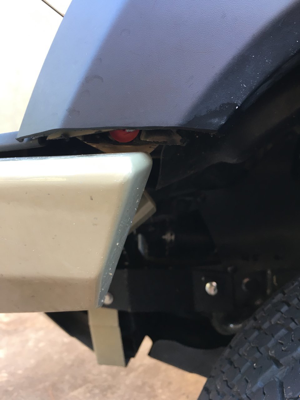

    I know this thread is a little old but I stumbled over this thread since I have the T3 bumper installed. I had a shop locally install it and I didn’t have such a great install experience. They butchered my truck and they cut the bumper cover uneven. Since then I had to purchase a new bumper cover and fender mouldings that I measured out carefully and cut myself. Hopefully it’ll turn out this time around.

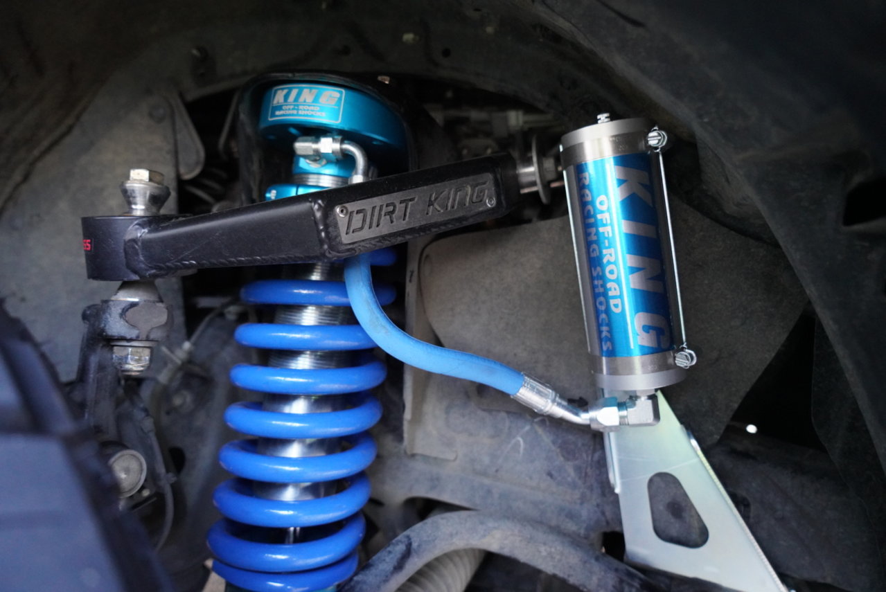

    Thanks for the info on this thread. Has anyone with Kings have issues installing the support brackets since the sway bar/reservoir brackets mount near the same location?
    Pic of reservoir bracket:

    If you have or plan on installing Kings you just need to let CBI know when ordering. CBI has a different bracket with the reservoir mount incorporated on it.
    I’m running BP-51s and the standard CBI provided bracket worked with them.

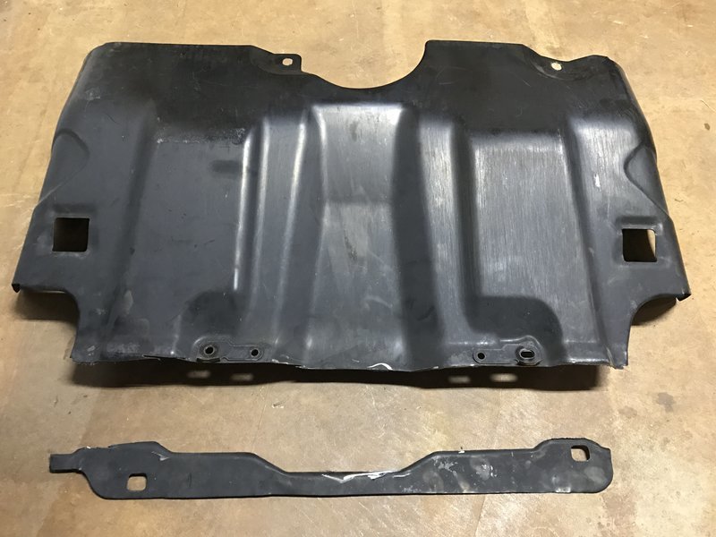

    Does anyone know what the big plates with one hole are for in this pic?

    I think I got it figured out that those plates go underneath the side supports and sit horizontally.
