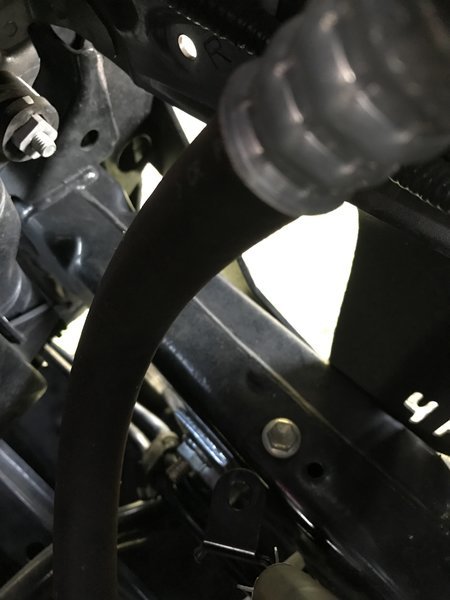

    Does anyone know what the rectangular pieces are for? Couldn't figure it out.

    It goes between the frame and the bottom bolt on the bumper.

    Okay, that's what I thought but it didn't tighten down all the way. I'll recheck it, thanks!

    Yup you’re suppose to have everything else loose to where it’ll move, tighten that bottom one first and then tighten the other ones

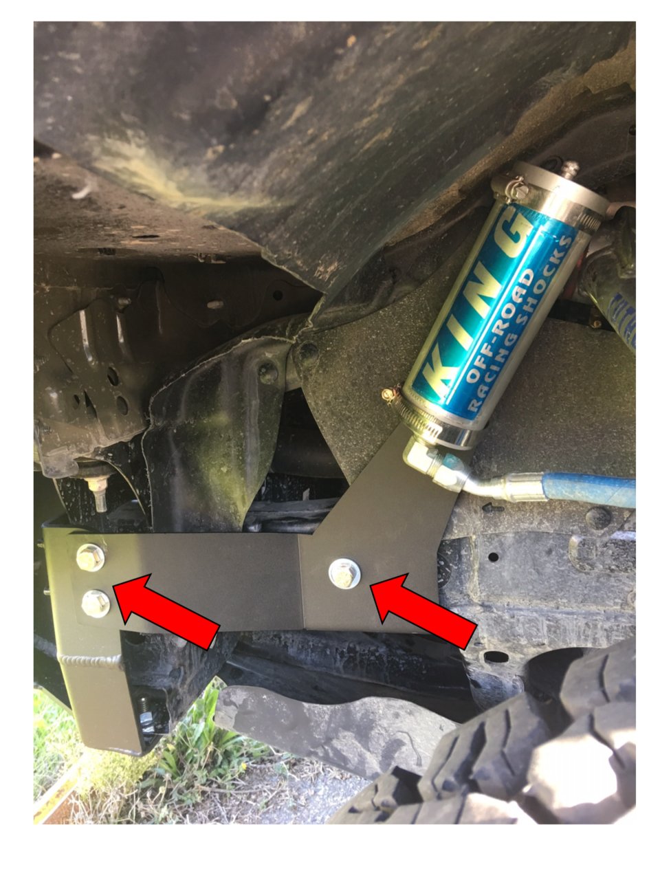

    Got my bumper on last month, but picked up the side support brackets this week (they forgot to include those). This picture saved the day as I couldn't find the .pdf install guide. Thanks!
