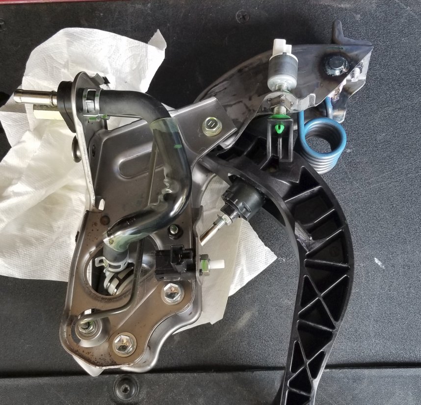

    Our pedal is glass reinforced nylon. So, the pivot on the pedal could get notchy from wear.
    The master cylinder could get worn where it gets a lip inside.
    Yeah. I was thinking about the shift fork pivot or other not so accessible parts in that area.
    If you can feel it sitting still, then you can get another person to pump the clutch while you listen in various spots. If you don't have someone else, you can use your phone or a GoPro to help. Tbe starting point is determining if it is in the cap or underneath.

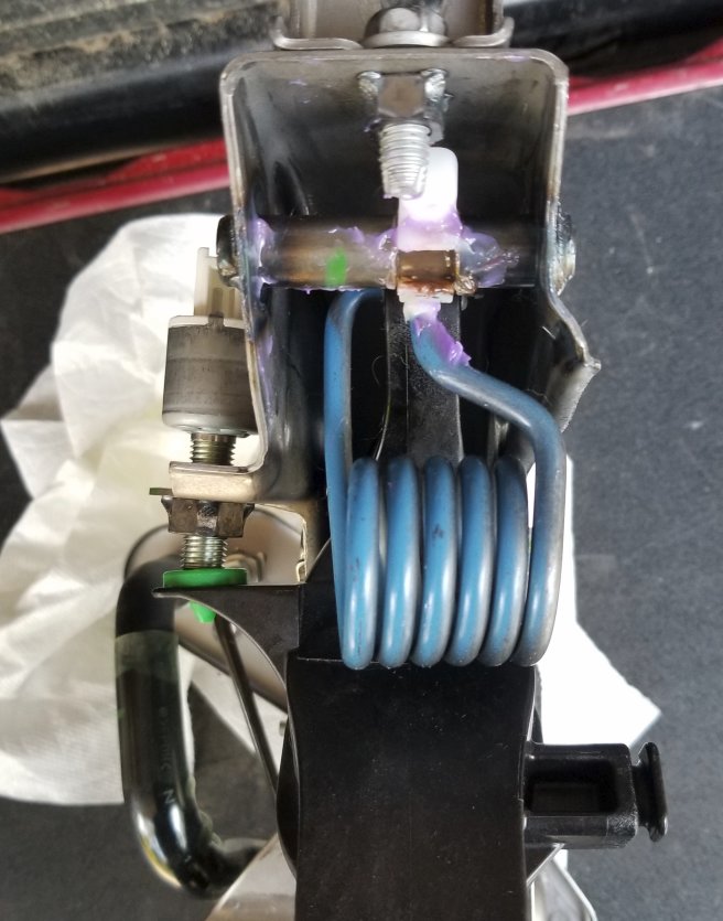

    There's a pivot point that could be the source...
    But I'd be more suspect of the spring. Usually it squeaks, but if your bushing is really bad, maybe it would clunk.
    This assumes that the noise sounds like it's coming from your footwell, rather than from under the truck.
