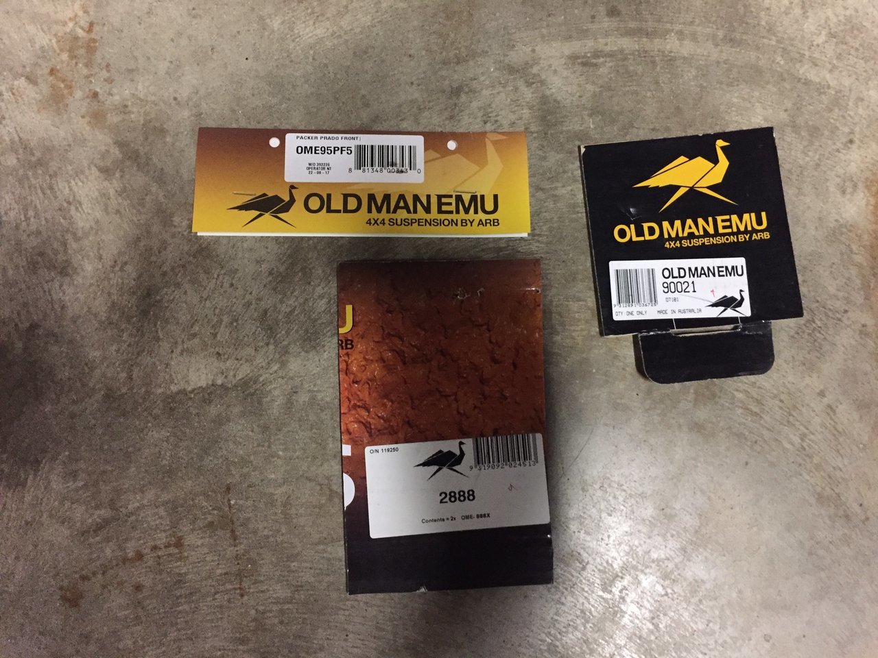

    Not going to post a bunch of information about this as many have done it and there is plenty of info on the site. OME 90021 shocks with 888 spring, standard Dakar leaf package, drop carrier install. Will post angles and overall measurements later on.

    Measurements before
    LF 38.25
    LR 37.5
    RF 38.5
    RR 37.75
    After
    LF 38.5
    LR 39.5
    RF 38.75
    RR 39.5
    @Phoosa @hoverlover
    4/21/19
    Aluminium spacers from @Wheeler's Off-Road Inc installed, pending alignment after install as also changed spc settings for castor of 3
    LF 39.25
    RF 39.5
    LR 39.5
    RR 39.5
    Heights changed after getting the alignment done.
    The tacoma came with a spacer kit installed.

    Parts used for lift, used 3 degree shim on the leaf pack as well.

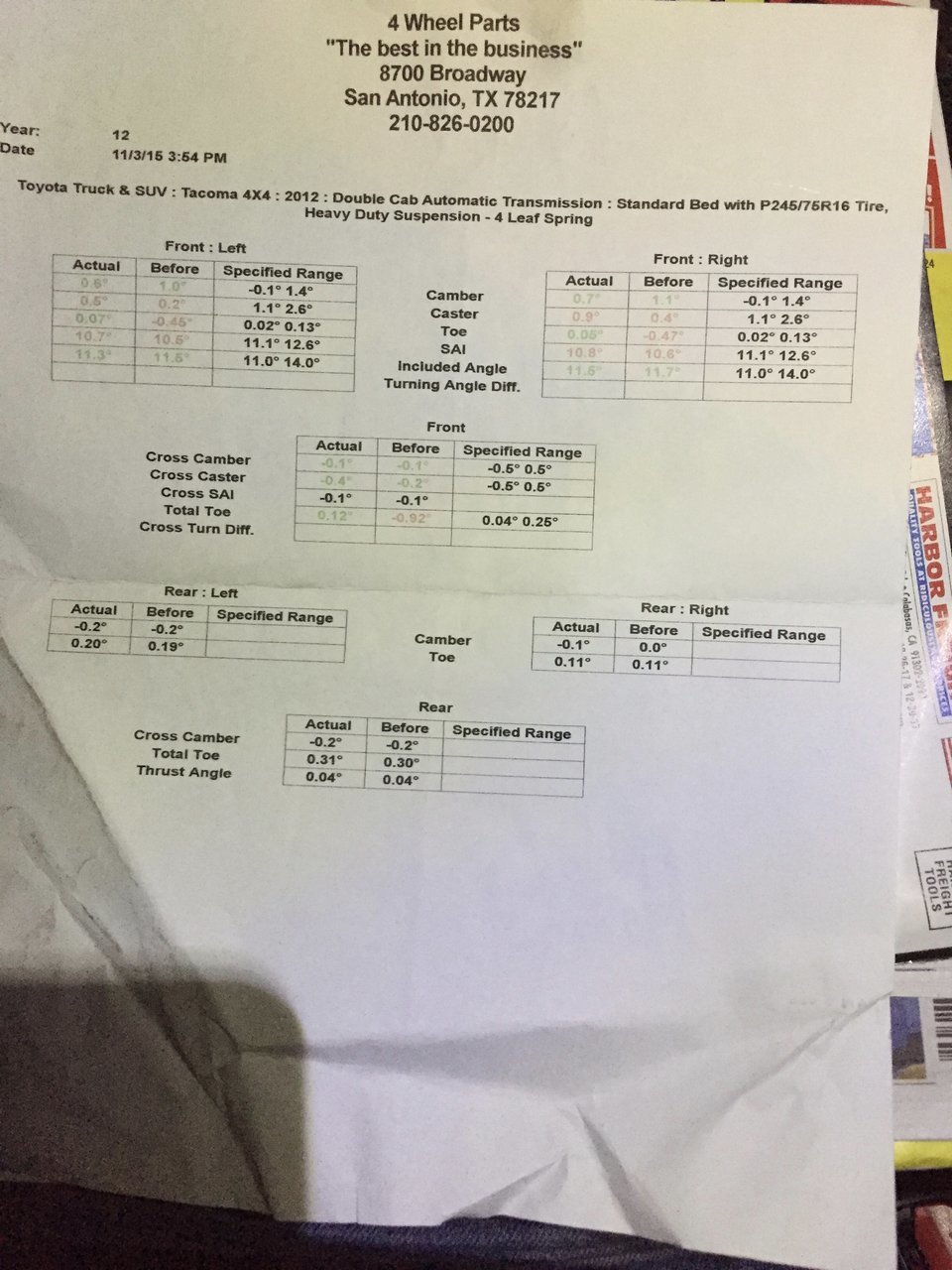

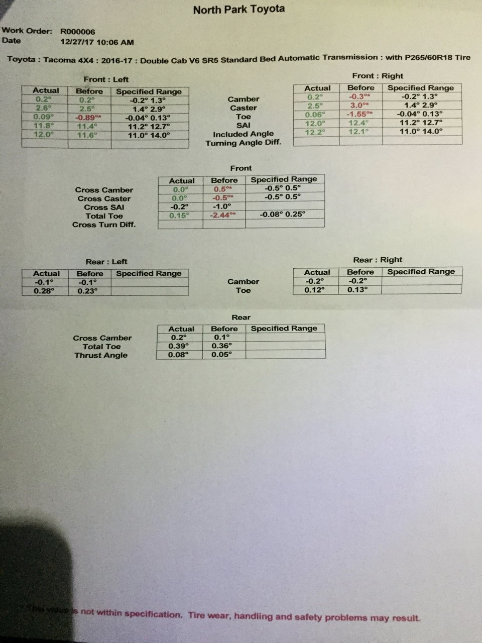

    Ok, as mentioned the truck came with a space lift when I purchased it. The alignment was done at 4wheel parts, now learning what I know now I would never purposely go shopping there. Below are the alignment before the lift I installed and after, the tacoma handles so much better.
    riz_atx and ChadsPride like this.

    A bunch a cool stickers, a bada ass MetalMiller Tx Longhorns grill emblem painted Hemi Orange, JBA long tube headers with o2 sims, Diff breather mod, Red LED interior lights, Fancy head unit that plays ipod n movies, Also DIY install factory stuff like, factory cruise control, factory intermittent wipers, OME nitro struts with 886x springs and toy tec top plate, JBA high caster UCA's for better alignmnet and dey beefier too, Old Man Emu Dakar leaf springs in da rear with the gear, U bolt flipper, Ivan Stewart TRD rims with 33" K Bro 2's, some bad ass weather tech floor liners so I don't muck up my interior, an ATO shackle flipper for mo travel in da rear wit the gear, also super shiny Fox 2.0 shocks back there too, all sorts of steal armor for bouncing off of the rocks like demello sliders, AP front skid, trans skid, n transfer skid, demello gas tank skid, and a tough as nails ARB bumper with warn 8k winch, I'm sure there's more
    I guess the Toyo tech didn't wanna give you the 3-3.5* caster.
    riz_atx and LostHusker[OP] like this.

    There machine was limited to 2.9 so the tech moved the bottom out to match up. I requested it but when he showed me the numbers and we test drove I was good with it. In the end I don't think he wanted to change the setting at the top with the UCA, told it was not hard but..

    10 Taco 4x4
    Hate to say it, but I call BS on the limitation. Glad it drives good though, that's the most important part.

    The tech said they bought a new machine last summer, he wanted a different one and he stated him and the shop foremen went round and round on it, but I'm not gonna argue with him as they didn't half to do the alignment. They were the closest shop to me that I would trust without driving all the way into SA.

    It's not up to the machine, it's up to the truck. The machine will show the numbers regardless, as you can see with your before specs.

    Well like you said, it does drive a lot better then it did. As of now I will leave it, Maybe later on I will rework the UCA and then have the alignment done again. At least now it doesn't want to dart to the right when I hit a bump.

    For sure, and your tires aren't going to wear unevenly either. Check the torque spec on the alignment cam bolts though. Should be 130ft#'s for your truck. If they're loose, they'll pop and maybe even move and fold the cam ears over.

    Verified it last night after coming back, still good. Will check it after I drive it some more.
