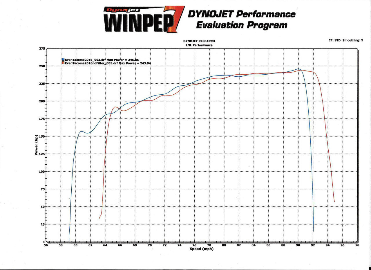

    For giggles, here is a graph of a 4th gear dyno pull with the Tacoma. Right at 110mph, the ECU pulled power big-time! I'm sure if it pulls timing, closes off the throttle-body, some combination of things... But it does NOT want to let the truck go past 110mph. That is why we had to make our pulls in 3rd gear.

    This, the computer is not doing anything to control airflow--it is however controlling fuel. This test shows that the air filter system is exactly what LnL said--ample in giving the engine enough air.
    I would bet if it was 45 degrees vs 108 degrees the engine would make more power.

    Yes, denser air (via lower temp) means more oxygen per volume, hence more power. But, the dyno corrects for atmospheric differences. Notice the "CF: STD" at the upper right, above the graph. That stands for "Correction Factor: Standard" being the basic DynoJet correction factor. I can turn the CF off, and get raw data, and in that case the low air temp would almost certainly be noticeably higher than when the temps are quite high. But with the correction factor turned on, I see surprisingly consistent dyno results (I've tested the same vehicle, with no changes, at different times of the year. That helps me feel comfortable that the dyno is performing consistently).
