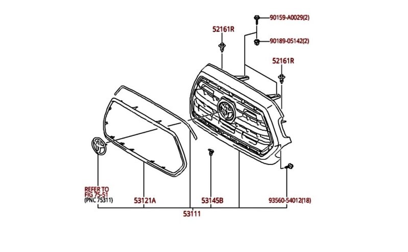

    I'll leave this here. I plan on removing the grille this weekend and painting it matte black. A quick look over and it looks like removing it will be a bitch.
    I plan on heavy sanding, 2 coats primer, 3 coats black, 3 coats clear. Any pointers?
    Let's use this thread to post tips and hints on removing and painting the grille.

    Having done it it's really not too bad. It's intimidating messing with something so new though. There are two metal screws on top of the radiator support, and then two plastic push pins to remove. Once those are off there are some clips along the bottom that you need to pull with some pressure to release. That's the scariest part. The grill is two pieces and held in with a handful of phillips head screws. Also getting the chrome ring and grill out of the assembly sucks because of the multiple clips that hold it in. I broke one of the tabs getting it off :(. But I'm not worried since it still secure, and I'm holding out for a possible TRD Pro grill in the future.

    In all fairness everyone, 2T3X1 gave me the diagram on Reddit.
    I'll post pictures when I eventually get to the project.

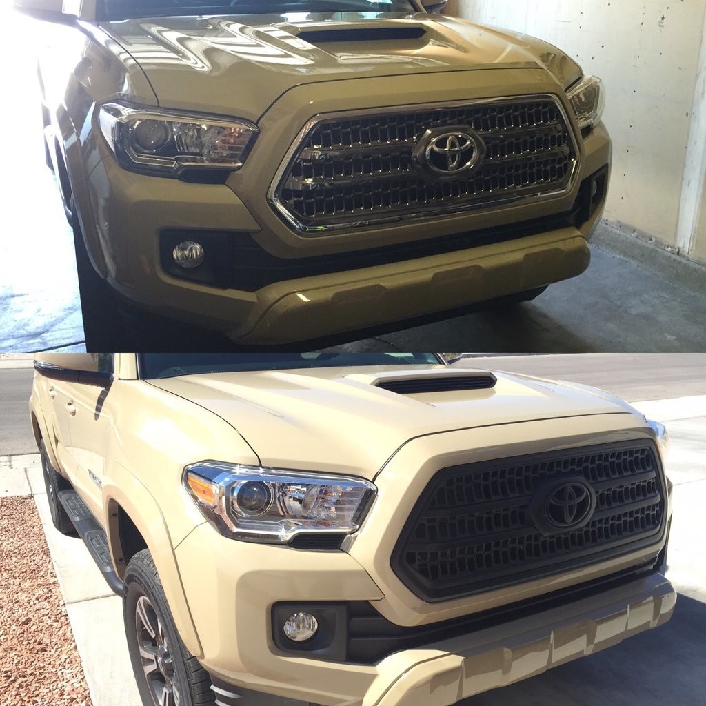

    uploadfromtaptalk1447216757231.jpguploadfromtaptalk1447217216008.jpg just did mine!

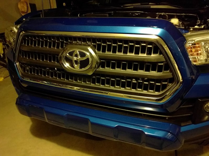

    I photo-hack-jobbed this:

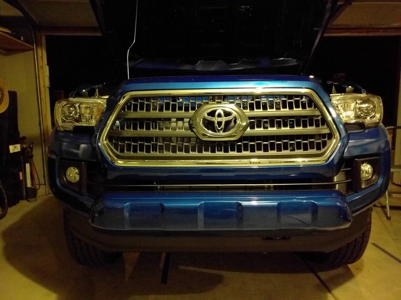

    Did mine last night. The chrome outer needs to come out first, then the center mesh will unclip. Careful with the chrome logo it is brittle. I am thinking I will go body color with the outer thin surround to make the grill look slightly smaller.
    This is what it looks like now.

    Is that rhinoliner? Thats actually a really good idea for durability. They also make a spray can of bedliner that may hold up better than plastidip. I always get worried with plastidip and carwashes.
