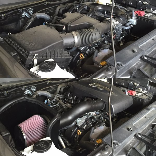

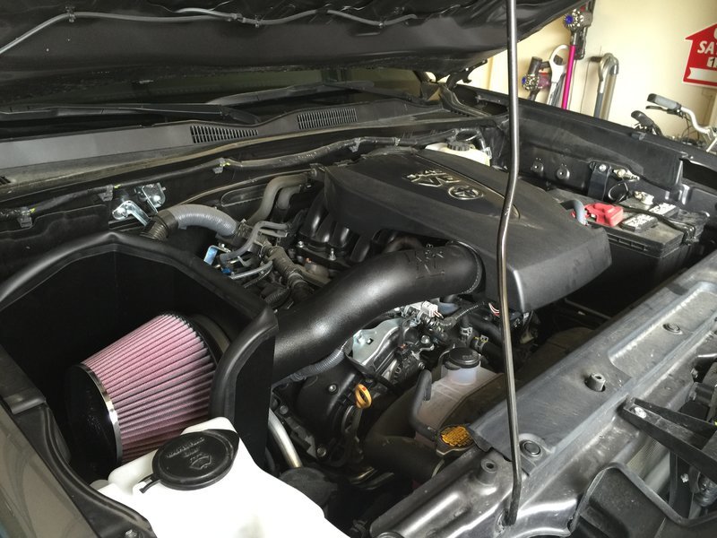

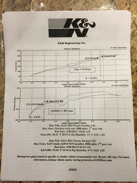

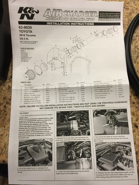

    Installed my K&N intake couple weeks ago. Couldn't upload photos because I was out of the country. These are the papers that came with it... Dyno tests and install instructions. Heard a huge difference in sound. Feels like the truck is way more responsive now.
