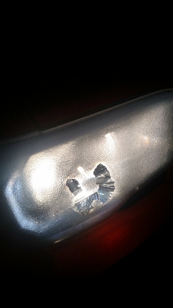

    So... This is a picture of my headlight today after an afternoon of freezing mist.
    The spot you see is the halogen light melting the ice as I started the truck and scraped the windows (heated mirrors are amazing btw) which led me to wonder if the LED light will be able to do the same?

    No. The LED's don't radiate enough heat forward like halogen or HID. Unless you design the heat to cycle from back to front the headlights will always build up snow and ice in extreme weather. LED's need to remain cool in order to maintain their reliability.

    Nope. It's designed to get heat out the back, not push it forward. :(
