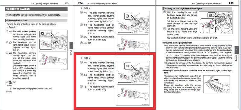

    No "off" designation
    Apologies for the poor image quality--got it from another thread on TW

    This means if you have an “Off” or “DRL Off” position on the stalk, you’re good to go right?

    Exactly. Otherwise the turn signal tells the headlight to put the turn signal on ALL THE TIME (since the DRL is the turn signal on those models and cannot be turned off).

    so what trim levels are affected? Because the SR and SR5's don't have that stalk

    Any models with that stalk. I'd imagine the lowest of the lowest have the least options for lighting.

    i don't think those stalks are on any 3rd gens. here is a 2016 SR utility pkg (lowest of the low) and it has the ability to turn on and off DRL's (0:36 mark)
    https://www.youtube.com/watch?v=Y9ZUAHZUQVk
    so based on what you said, the stalk found on that video shouldn't cause any problems with the headlights and we will get white DRL's?

    Correct, since it has the "off" option for the factory DRL.
    I wonder where that stalk is used if not in any of these trucks since this appears to be a snippet of the stock 3G manual. Bizarre!
    Edit: Canadian trucks perhaps?

    that's what i've been confused about the past couple days.
    do you know what test vehicle the non-conformity was discovered on or is this the case of an engineer looking at schems and not realizing that 3rd gens don't have that stalk?

    Not all trim options are US releases.
    Perhaps another market prohibits disabling the DRL's.

    Someone mentioned it to us, and this was the only mention we could find of a third type of DRL configuration. I wonder if the base model Canadian trucks are the outlier here.

    i think this may be the case.
    they're the only country with some semblance of mandatory DRL laws. everywhere else (US, mexico, south america) that tacomas are sold does not.
    edit: SR utility pkg aren't available in canada so i'm at a loss for where you can find those headlight stalks

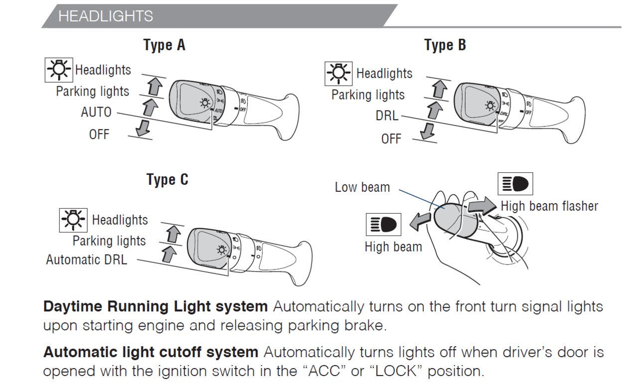

    From the manual...better image...

    Thank you!

    2019 SR owner and I have DRL Off.
    Suspect maybe 16-17 Utility Package trucks could have the problematic stalk?
