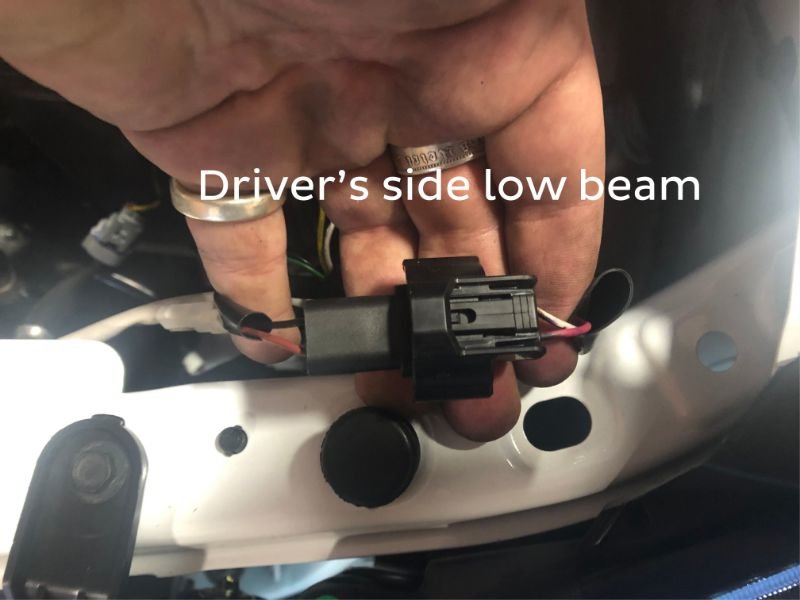

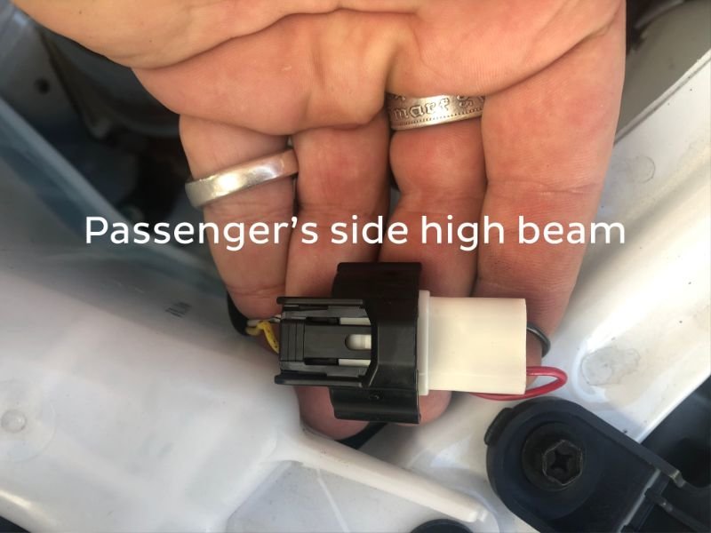

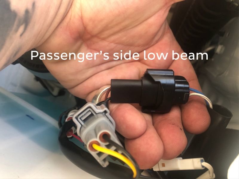

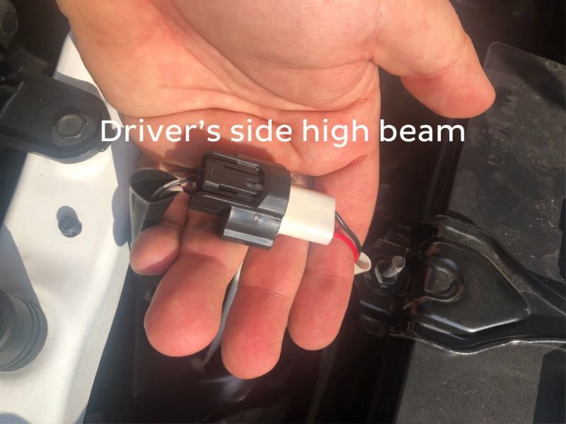

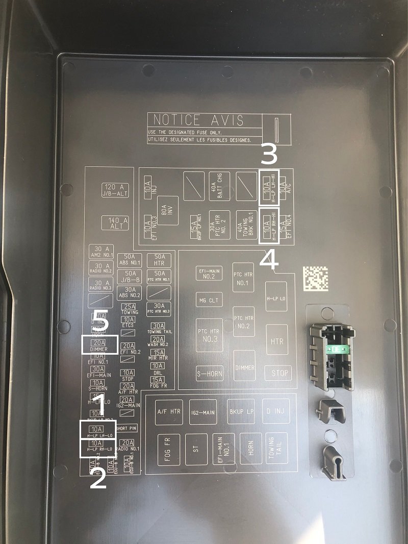

    I will work on getting this same info added to the installation guide, but until then, this info WILL help you not pull all your hair out should you blow a fuse due to incorrectly plugging in connectors.
    SHOULD YOU BLOW A FUSE FOR LOW/HIGH BEAMS: (This is the large fuse box behind the battery on the driver's side of the engine bay)
    1 - LH (Driver's side) Low Beam
    2 - RH (Passenger's side) Low Beam
    3 - LH (Driver's side) High Beam
    4 - RH (Passenger's side) High Beam
    5 - Printed as "Dimmer" but this is for BOTH high beams
