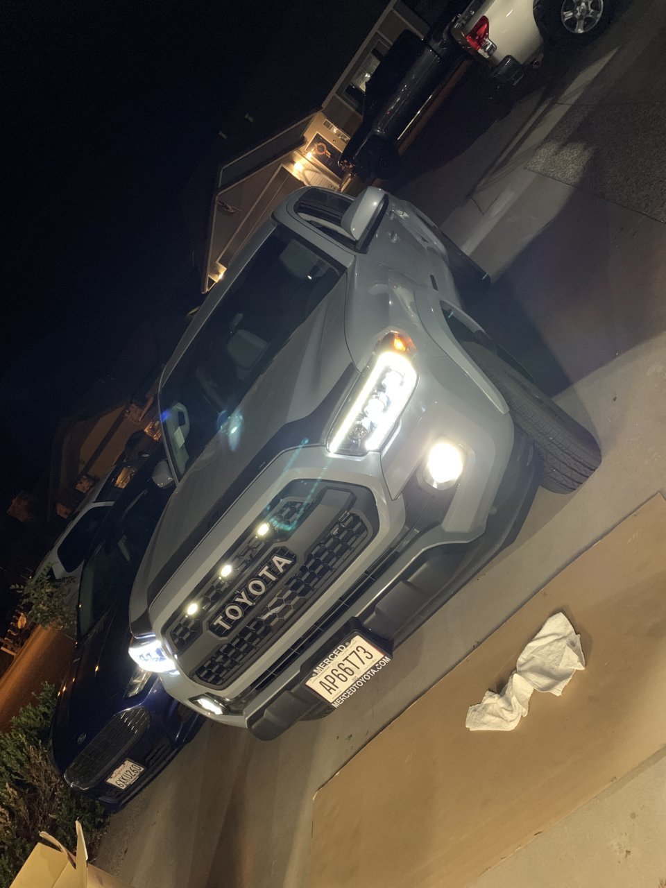

    Man this would have been the greatest thing an hour or two ago... nonetheless i figured it out! They’re amazing! Wondering if someone could break down the adjustment knobs, was messing around with it, but got late. Will look at tomorrow.

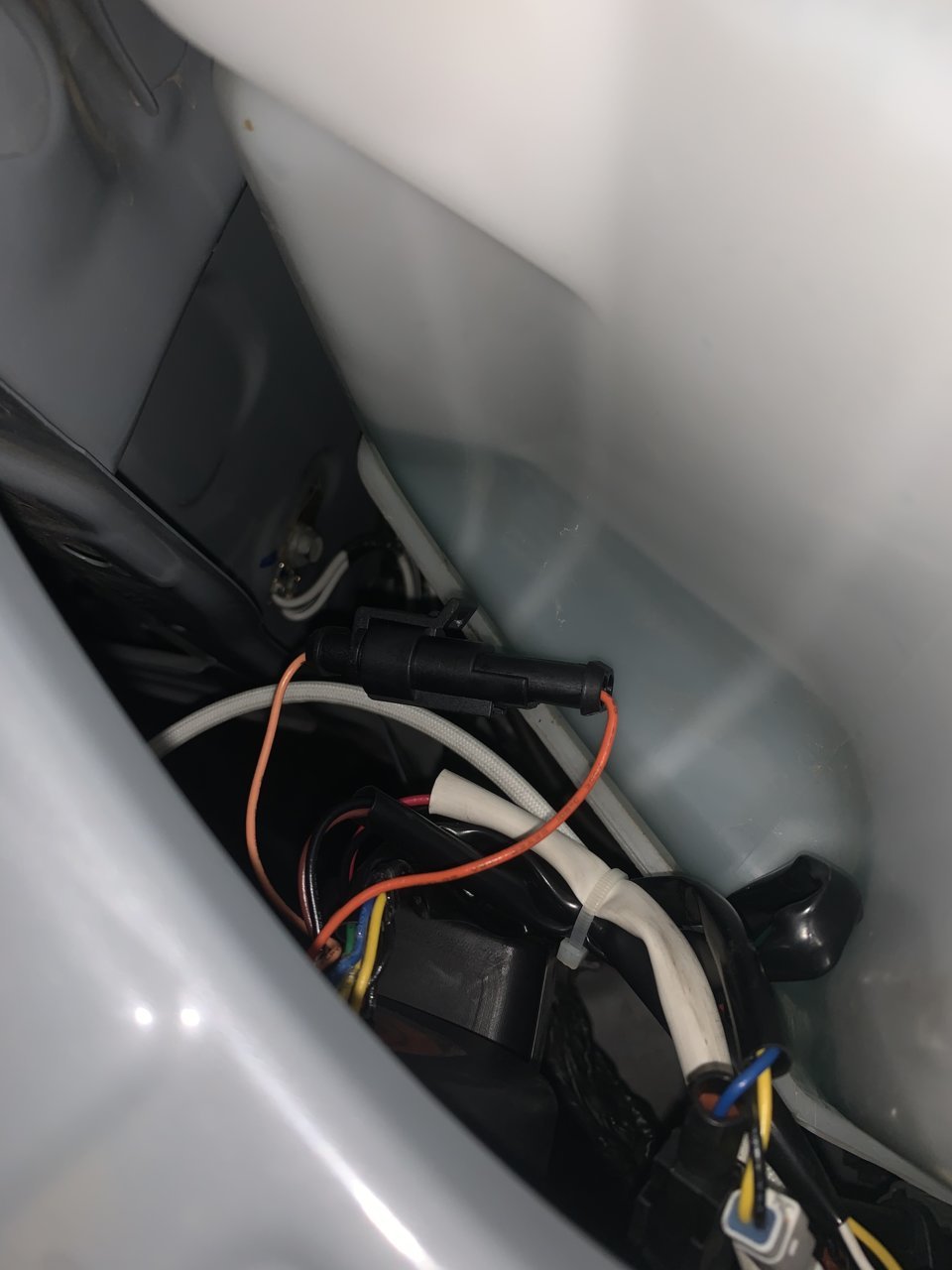

    I just got the lights installed. Confused why the sequently turn signal function isn't working. Following the instructions and unplugged the single blue plug-in on both sides. Any thoughts?
    Also, when I have my headlights set to auto, during the day time nothing is on. I thought the DRL was on all the time, unless you turned the headlights to "off". Any thoughts about this too?

    I think I know what you may have done. I tinkered with it for awhile, keep in mind I have a SR5 Tacoma that used the turn signal as DRLs.
    The temporary guide doesn’t accurately describe which wires you need to leave disconnected for sequential turn signals. In my case the wires were both orange and preconnected. Once you disconnect them, they should be sequential.
    I believe you left the wires that go to each headlight with the fuse tap disconnected, if you do that then you won’t actually be running the DRLs but a dimmer version of them when the headlights are on. In the OFF position the DRLs should be 10x brighter on than when the low beams/hi beams are on.
    The question I have for anyone that may have an answer for is... When I have the lights on DRL or Parking lights, the ambers stay steady on. I’m assuming this has to do with my truck not having DRLs originally and using the turn signal. Wondering if there’s a wire I can splice, cut, etc that would turn the ambers off in these positions and allow for the DRLs to be in (just as bright as when it’s in the OFF position). Main reason is to have my fog lights on without running my headlights.
