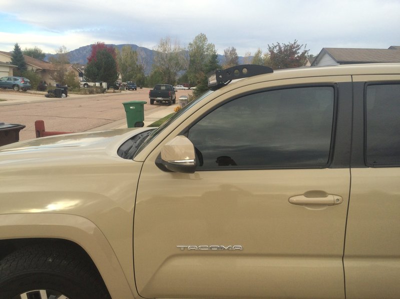

    That looks great! So does that mean @RelentlessFab has mounts for sale for 3rd gen? Also how much added height does that give you? I only have 3 inches to spare from the top of the antenna. Otherwise my truck won't fit into the garage.:(

    They're the same as the previous gen. Doesn't really add any height, it nearly sits perfectly on my windshield line. With the mounts being curved it say the mounts might stick up an inch or so. image.jpg

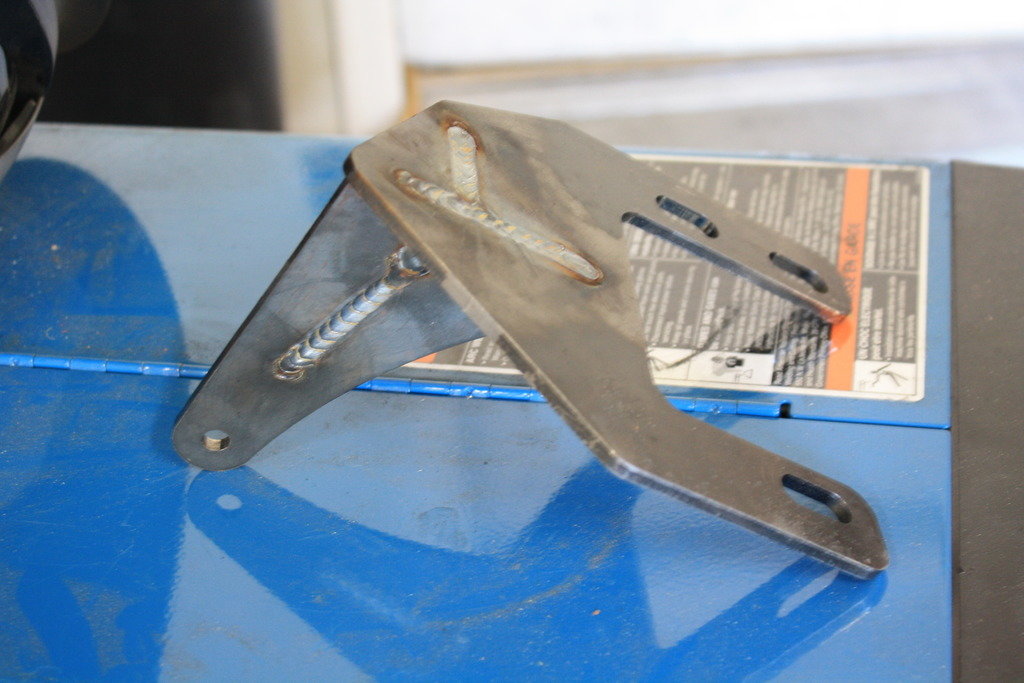

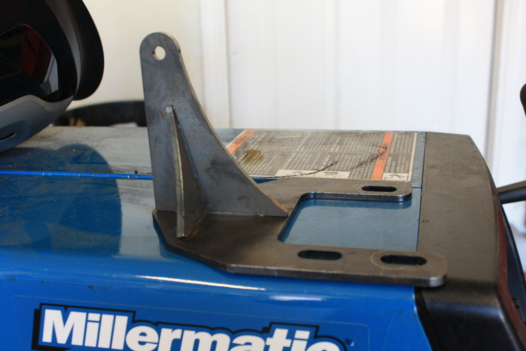

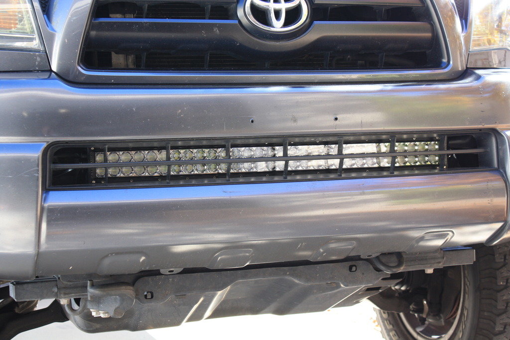

    Just a heads up, I am planning on making Stealth and Flush style mounts for the 2016 in the next month. I need to get my hands on a truck for test fitting and design. If anyone is in ABQ.... I make them for 2nd Gen Tacoma's and 4th Gen 4runners. You guys are next. Will be priced the same as my others, $100 shipped. They will be powder coated black and will be made from 3/16" mild steel plate, laser cut for the best quality. If you are interested in getting on a waiting list, shoot me a PM. I will post pictures as soon as I get to make something!

    how does that mount go in there? What's it attach to?

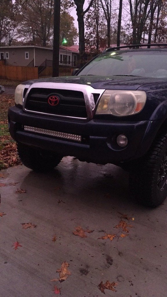

    that is the worst mounting I have ever seen. holy sht

    This is the 2ng gen mount. Bolts into the factory bumper bolts. On 2nd gens there are 3 nuts on each side that come off. The mount slides into the studs that hold on the bumper, then the nuts go back on, very simple.
