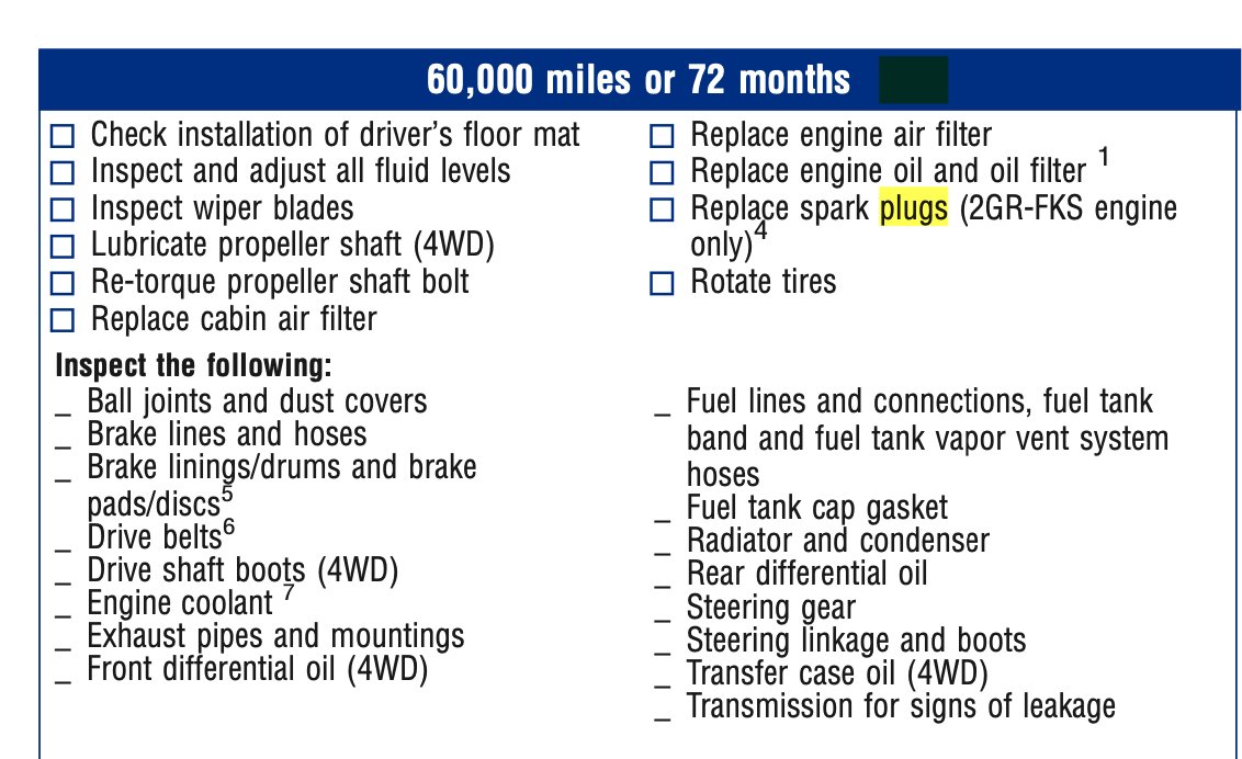

    it's every 60k according to the Maintenance Guide but the iridium-tipped plugs themselves are apparently heated for 120k
    I skipped the 60k interval because everything is running fine and I wasn't worried about the Emissions Control Warranty

    That’s interesting, never paid attention to that emission control warranty.
    I still think I’ll do mine at 60, it’s gonna take me another couple years at least to hit 60k miles.
