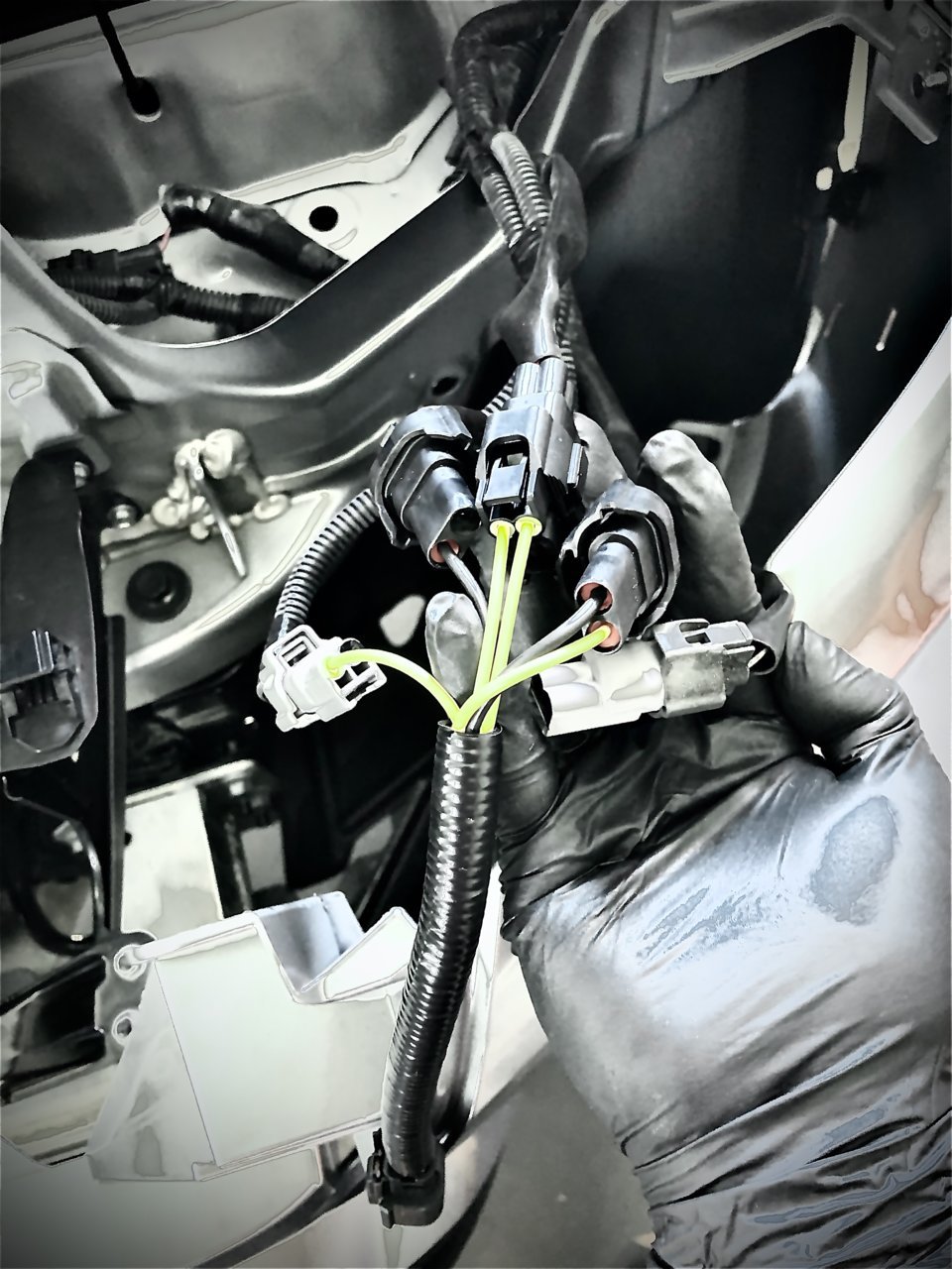

    Nope. I marked the low beam plug before getting started. You can always just use a tester if you already removed them and have them mixed up.

    The low beam is the single yellow wire and high beams are the yellow and black wires.

    Just mark your low beam before unplugging the connector from your stock headlight;
    LOW: YELLOW connector
    HIGH: YELLOW & BLACK connector

    and the low beam connector on the harness is green inside and the high beam connector is yellow on the truck harness.
