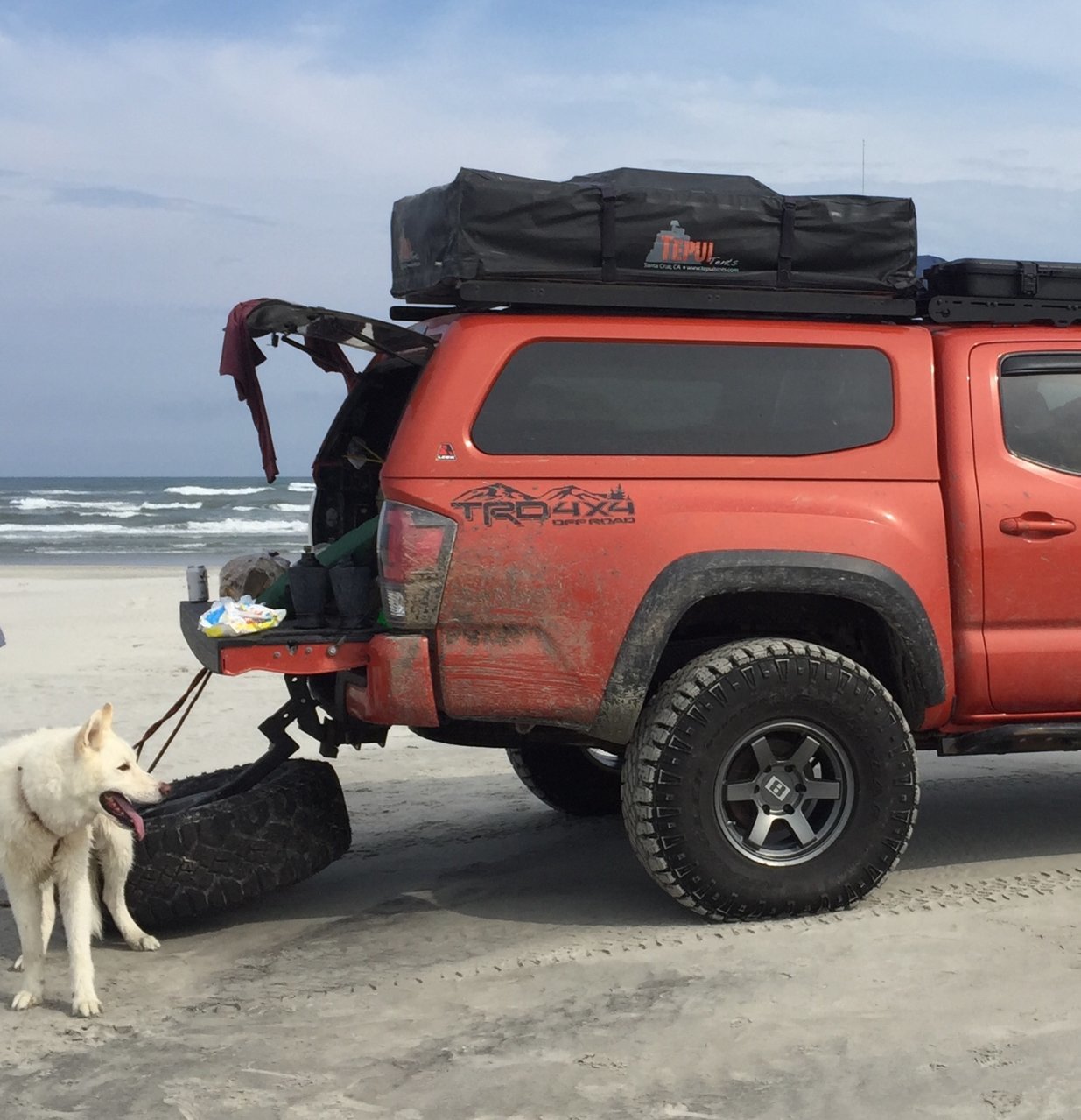

    Where did you buy your spare tire carrier?
  20. Jan 25, 2019 at 4:26 PM
    #2140
    Dogg23
    Dogg23 I like big tires
    Jul 31, 2015
    #160766
    292
    Nate
    Rochester, NY
    16 DC OR MT 10 Sport MT & 16 4R Trail
    Big tires
    Curt tire carrier that I chopped up and welded back together so it hinged and gave more Clarence. I forget where I bought it from.
    The tire also makes a nice step when down.
