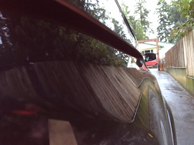

    Maybe it's the pics? Looks pretty darn straight to me from this angle.

    Maybe just the factory rake? It creates that illusion with most caps I've seen.

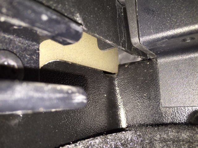

    so most of the floor at the front was saturated with water,,all along the entire side of left rail below window and some on right and along sides of bed bed is wet,,i have the bedrug in there so its really easy to tell what is gettin wet and whats not,,the slider part of this window feels like there is no seal around it as its sitting really loose while the right side is tighter,,theres small slots that you can see in pic below,,that will need to be sealed ,,any suggestions ??[​IMG]
    above is frontleft corner,,you can see the slots where the water is coming through ,,the right is same

    In my third gen, I did notice some water coming in too but the problem was not the shell. In the front part of the bed, at the junction of the front panel and side panels, the plastic bed does not go up to the flat rail where your bed sits. I suspect this is because the sides have been raised an inch from previous year but they kept the same plastic mold for the bed. So I had to do a couple of patches from inside the bed with black silicone. However, I do not think you can see it, it would be under the rug. Water came in mine only if I was traveling in rain. Parked it did not seem to be a problem.

    Can you show me a pic of where yu siliconed ,, ?? Doing my mine today
