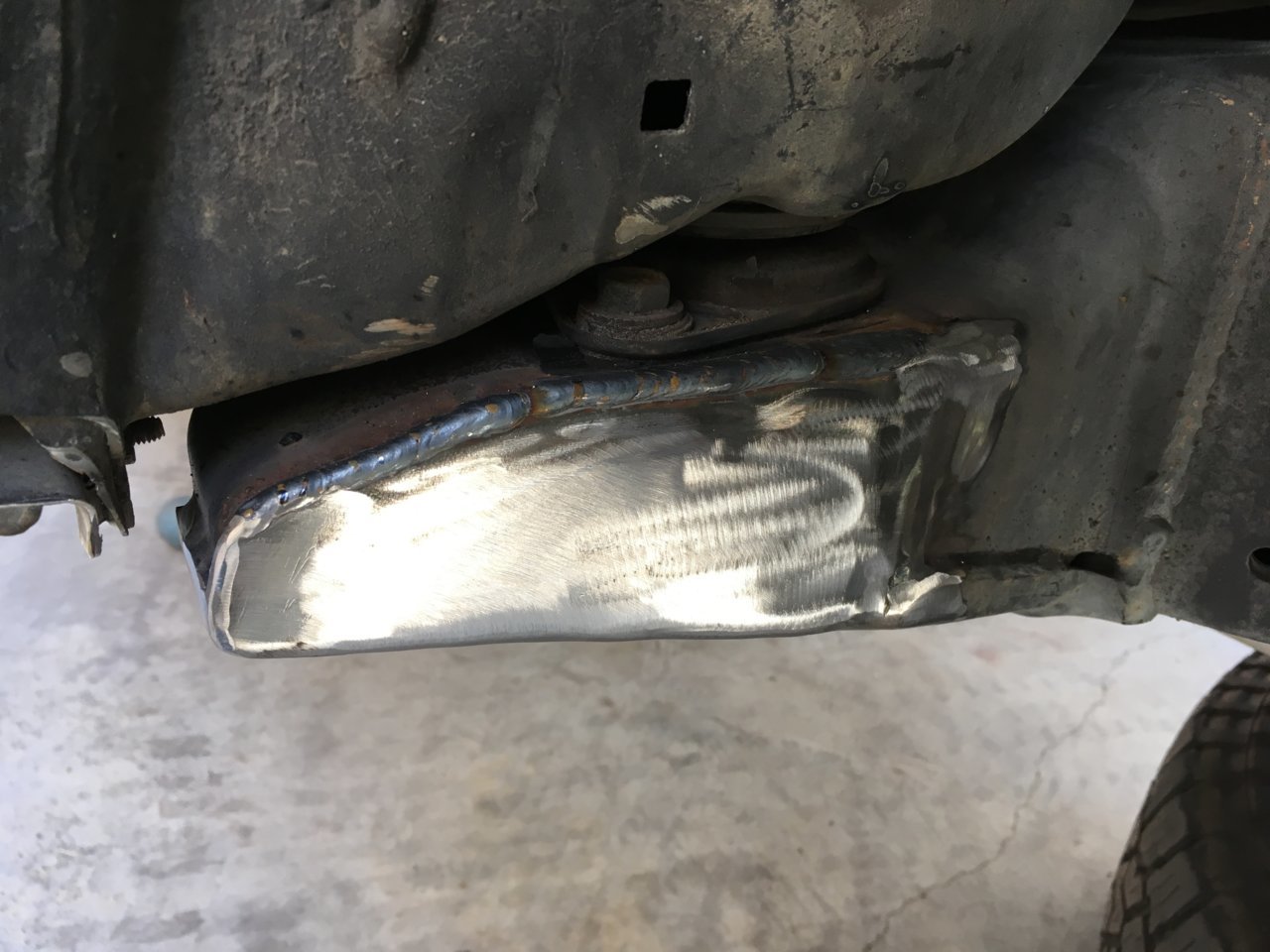

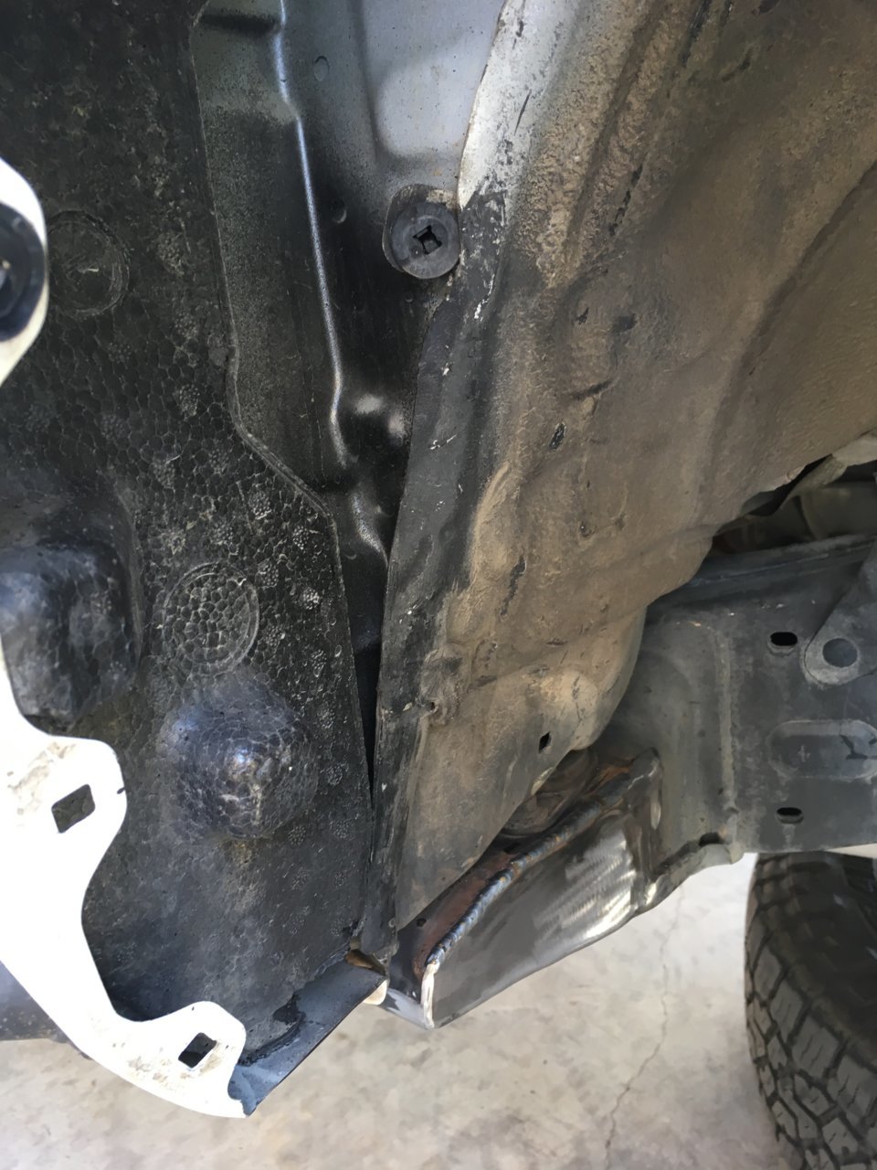

    8E2361FB-E416-4855-87D8-0B0006F639A5.jpg B70554FE-7C29-4BF2-8BD8-CA9320FFB833.jpg 9/22/18 Did my own Cab Mount chop using BAMF plates.
    Also flattened the pinch weld and used a heat gun to remold the fender liner.

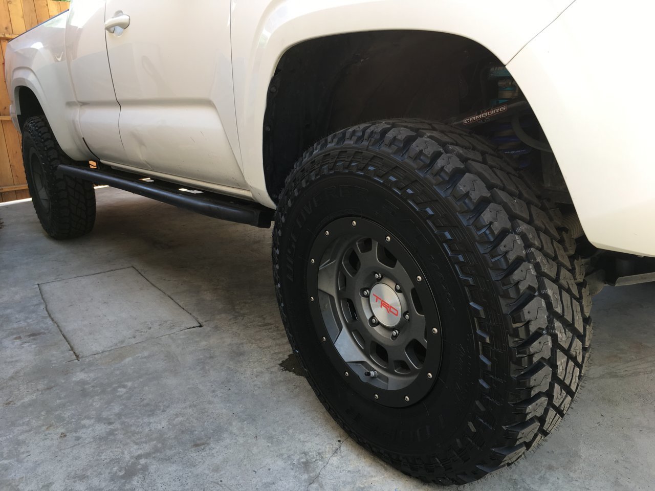

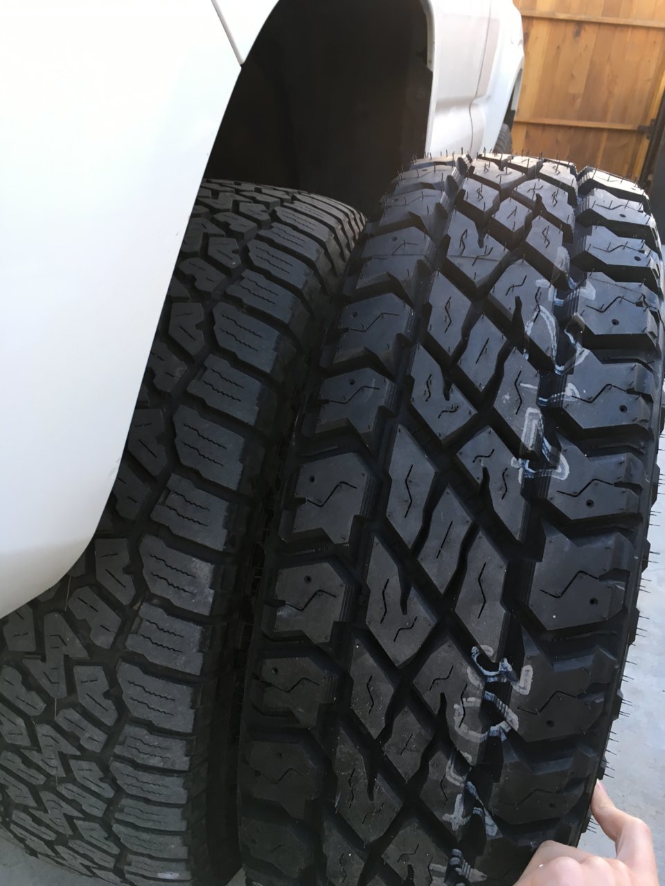

    9/22/18 New tires. 255/85R16 Cooper ST Maxx.
    Also painted the trd wheel rings black.
    265/75r16 vs 255/85r16

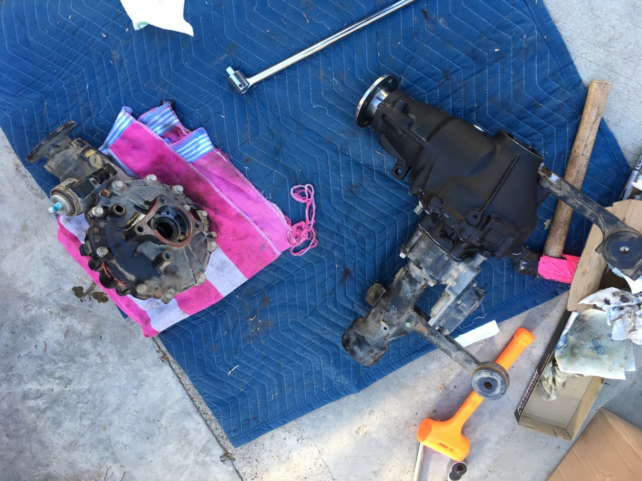

    Regeared to 4.88 and an ARB locker. Used a built 3rd member and front dif from east coast gear supply and installed them myself.

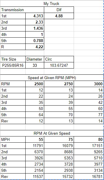

    I decided to go with 4.88. The reason for this is that I wanted an increase in power/torque (mechanical advantage) and still wanted to maintain reasonable drive-ability at high way speeds. 5.29 would have highway RPM's in 5th gear too high, and 4.30 would basically just barely be enough to offset the increased tire diameter of a 33" tire.
    To see what kind of RPM's I would be turning at certain speeds and help me make a decision on the gear ratio, I made the following spreadsheet:

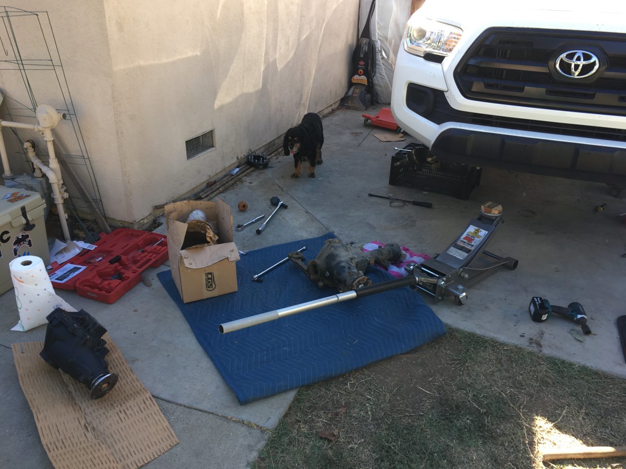

    The rear 3rd member and front dif were purchased from east coast gear supply. There is tons of information on how to swap the new parts in and take the old ones out. This can be done in a weekend, you will need help getting the difs back in, they are heavy. The rear end took about 2 -2.5 hours start to finish, other than waiting for the RTV to dry (24 hours before I could fill it with fluid). The front end takes significantly longer. Nothing is overly complicated or difficult, it is just a large amount of labor and takes time to make sure everything is done correctly.

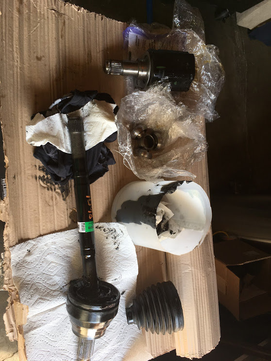

    Baja Kits LT kit on order.
    Bought two used CV's to build LT axles without having my truck down.
    It is extremely hard to get the outer CV separated from the shaft. Tried the Pipe method. Didn't get it.

    Read the TC axle building instructions. I used to use the pipe method, then I switched to doing it the tc way. It sucks but so far after a dozen axles it’s worked 100% of the time with no broken parts.

    Thanks for the advice, I have read the TC instructions and will likely have to do it that way. Other option is just asking Baja Kits if they can do it. I am waiting to get the kit and make sure the axles come with new C clips.

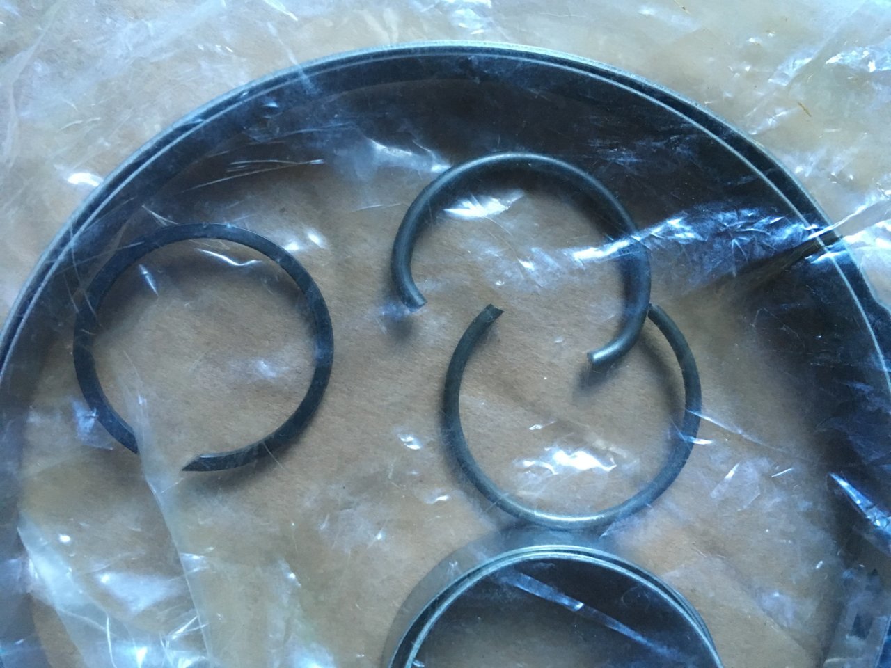

    I purchased two new cv boot kits for the extended axles i am building. The boot kit came with three C clips. The one on the left looks like the one that I took off to get the inner cv off the shaft. Does one of the others look like the clip that holds the outer cv to the shaft?

    It does look like those, but your replacement axles should already have them installed on it. It could also be the clip that holds the cv in the diff

    Cool. Thanks for the help. You are right. The one on top looks like the clip that retains the cv in the dif.
