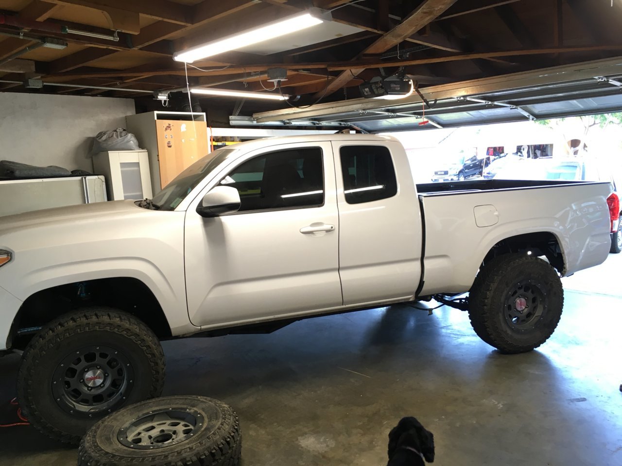

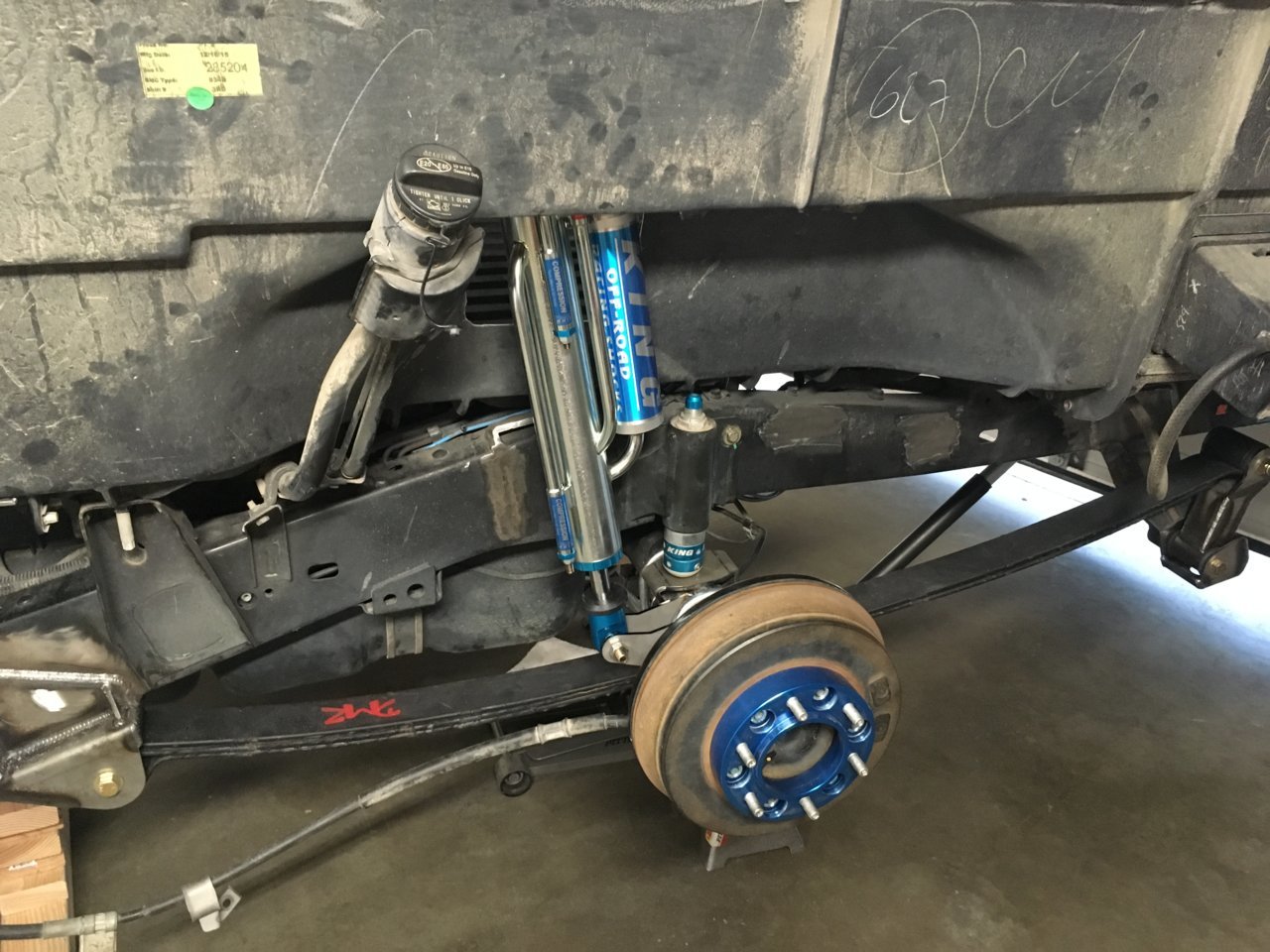

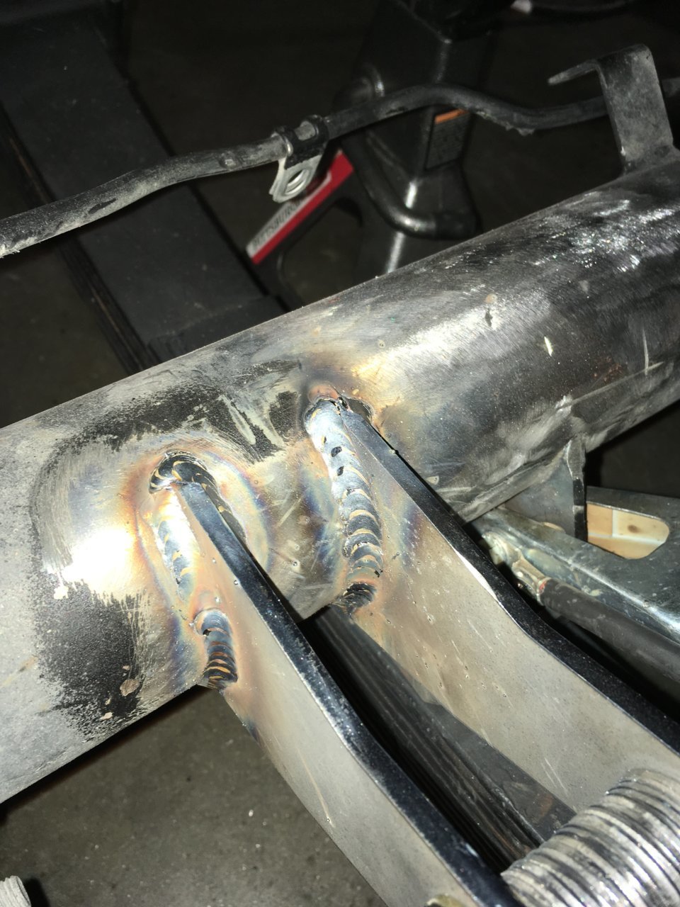

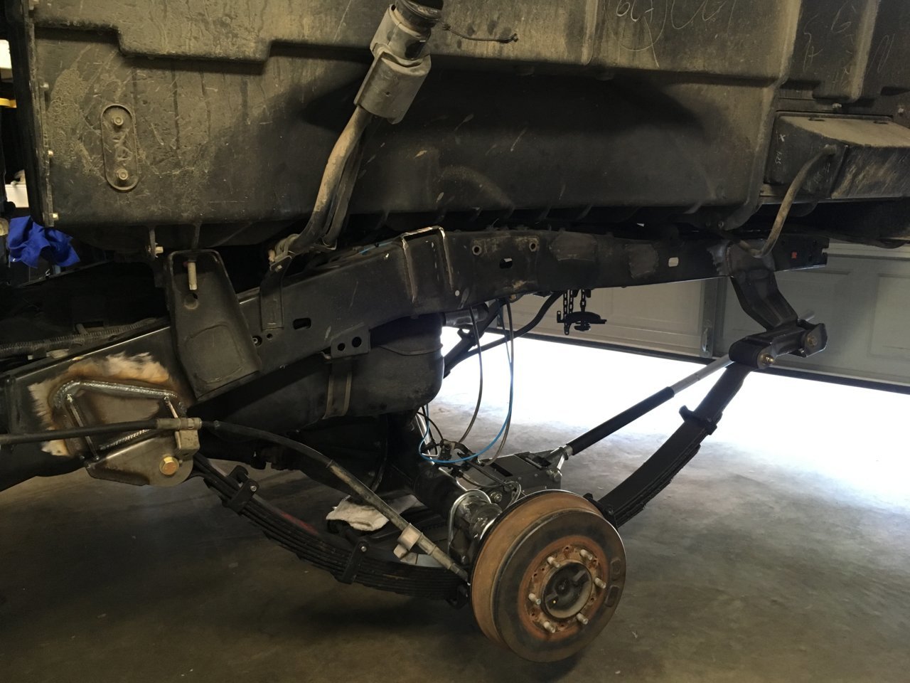

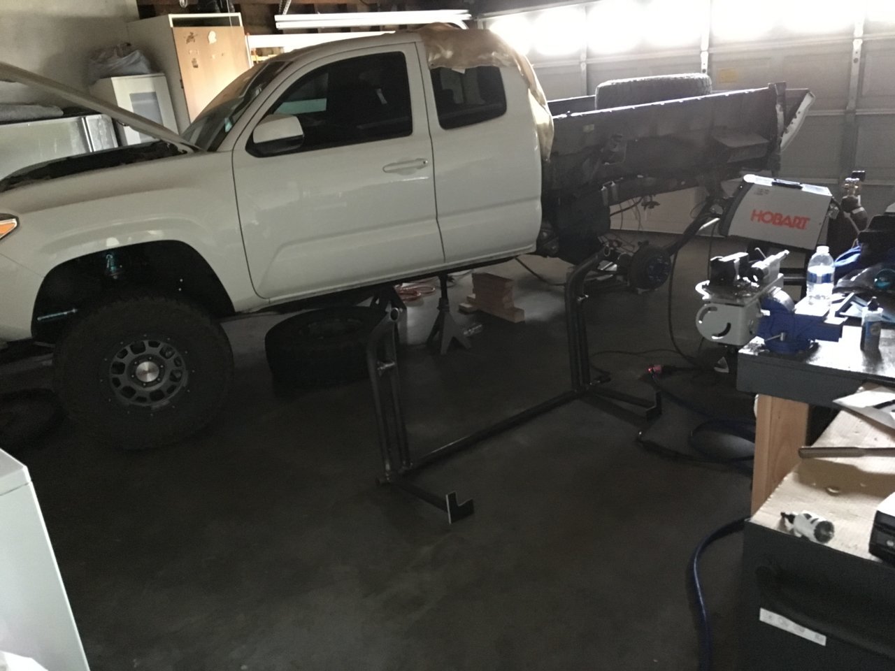

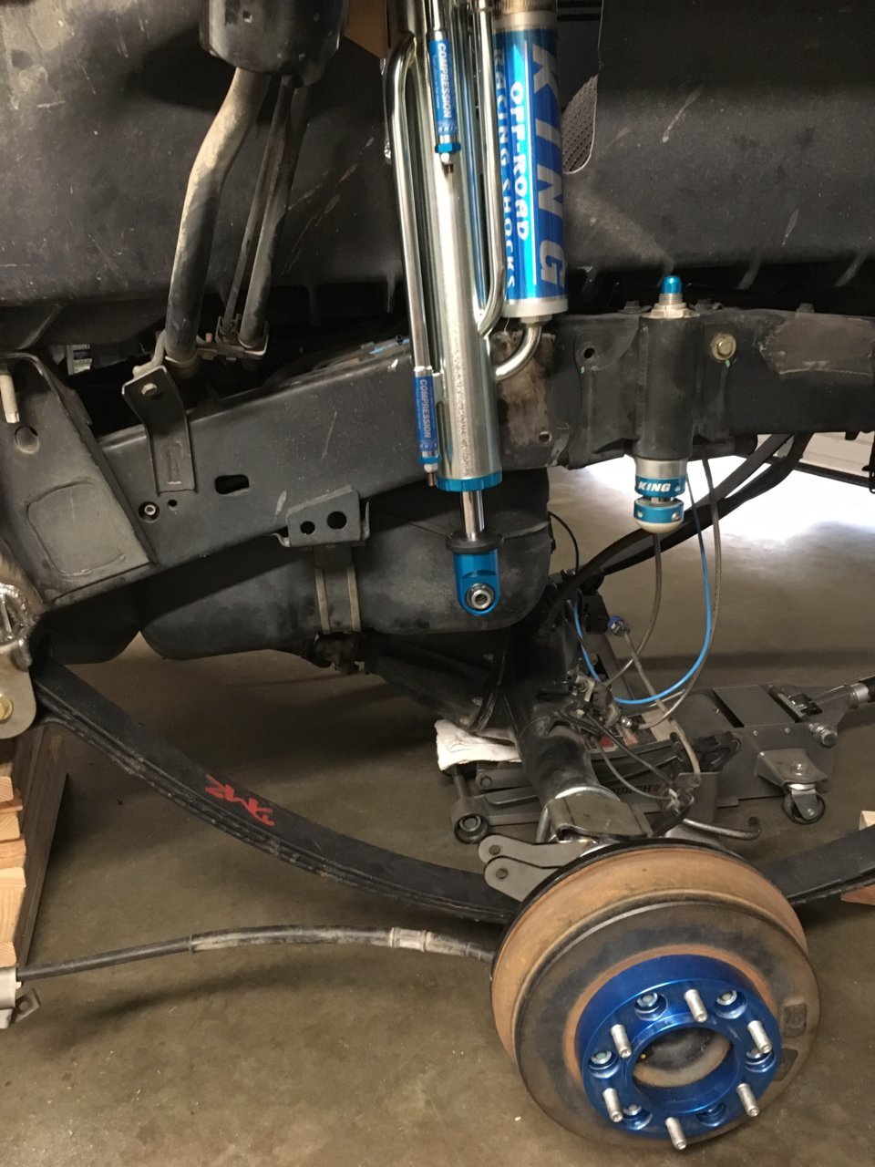

    Still working on the DMZ SUA install. Building my own bedcage.

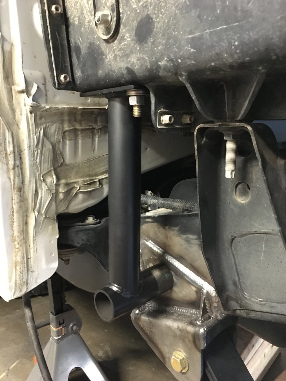

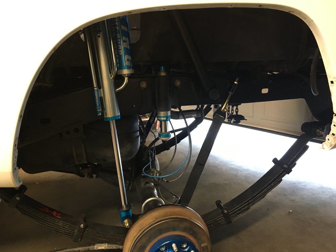

    Setting shock mounts / bump plates. Using my old bump stop mounts for now. The shocks are mounted so that I can get another 2” of up travel when I redo the bumps. That is a project for another time though.

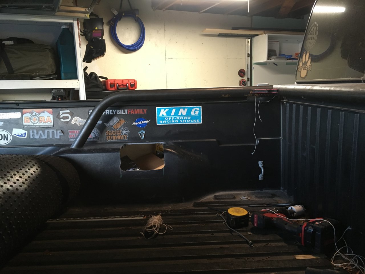

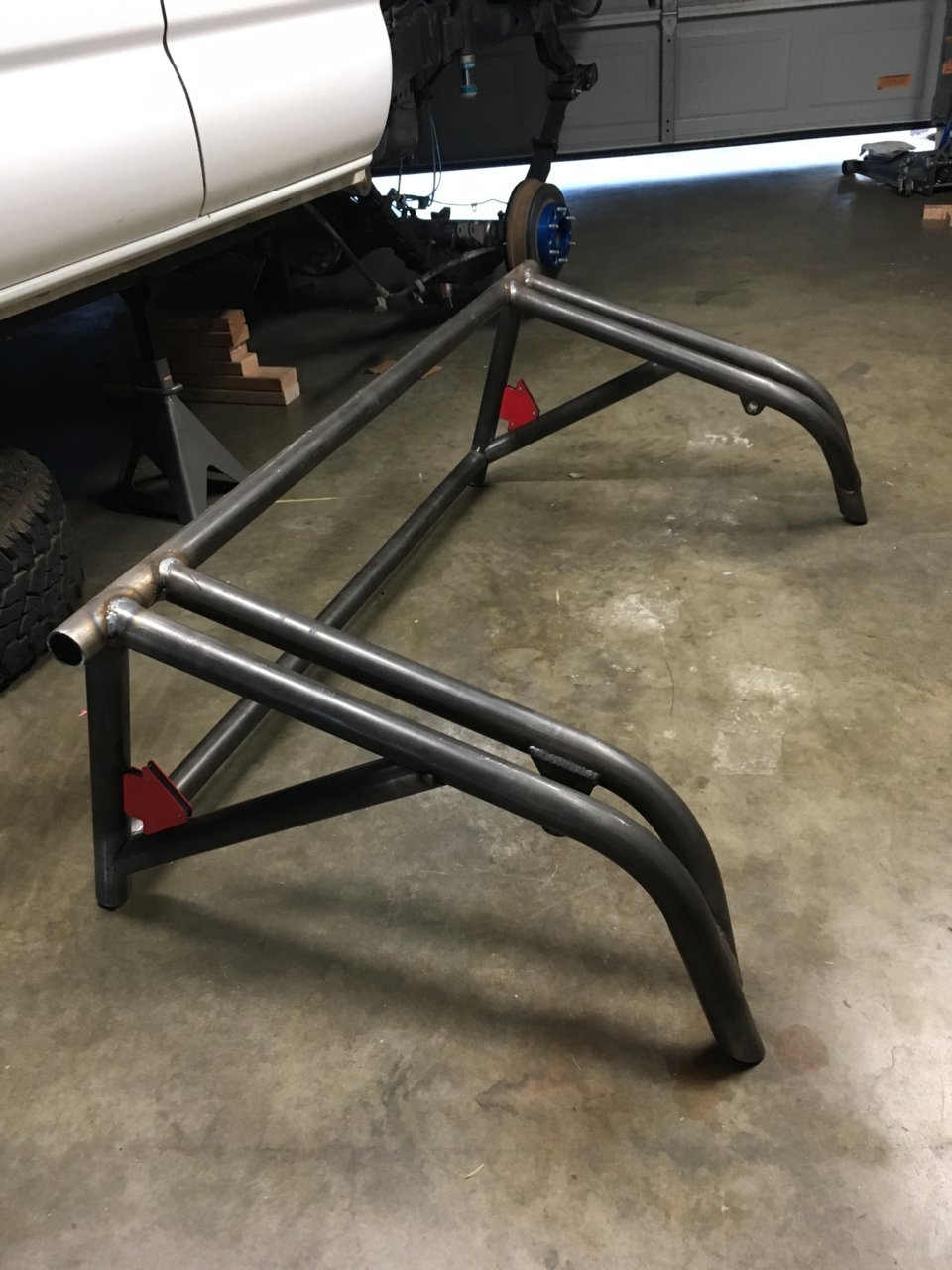

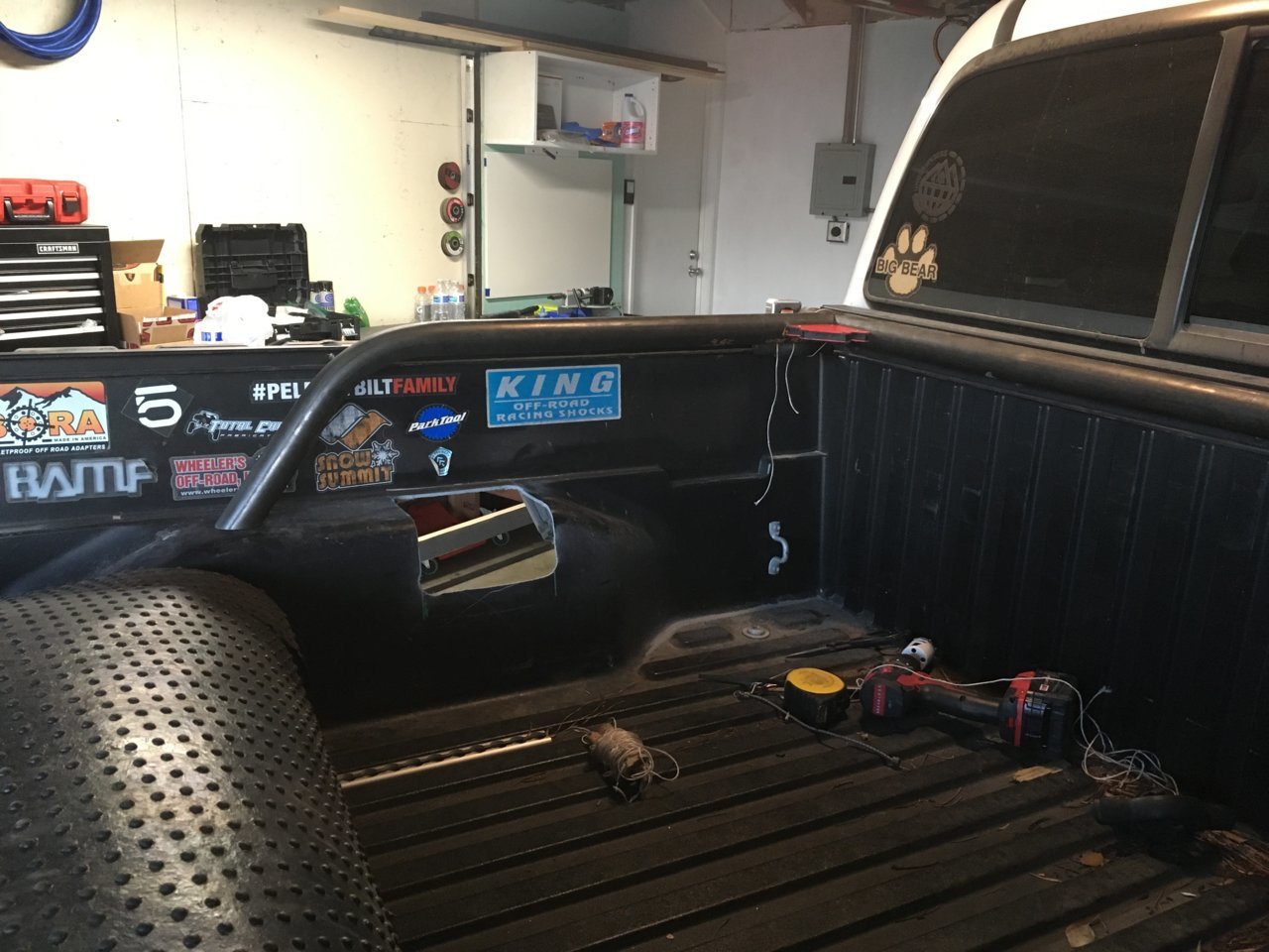

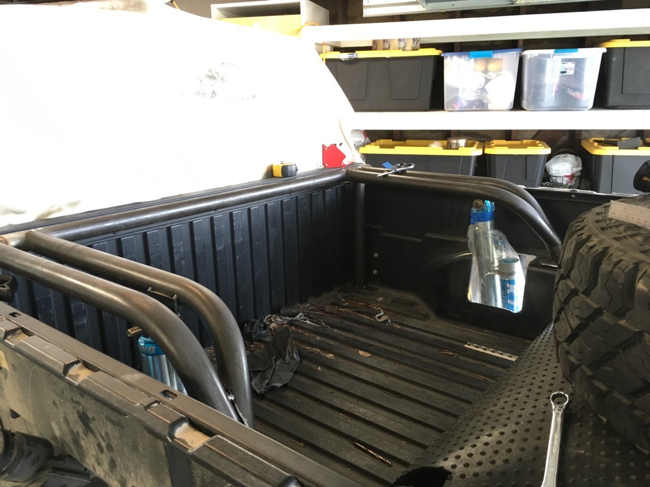

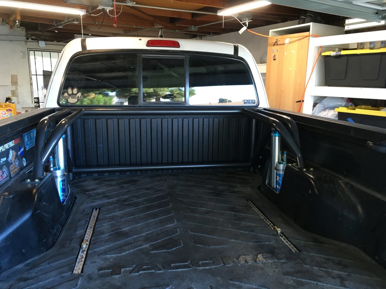

    Getting close to wrapping up the DMZ/LT install. Here is a picture of the bedcage. Made from scratch, by myself. Basically copied DMZ's design. Its not perfect, I am not a fabricator, this is my first big project. I am stoked how it came out.
