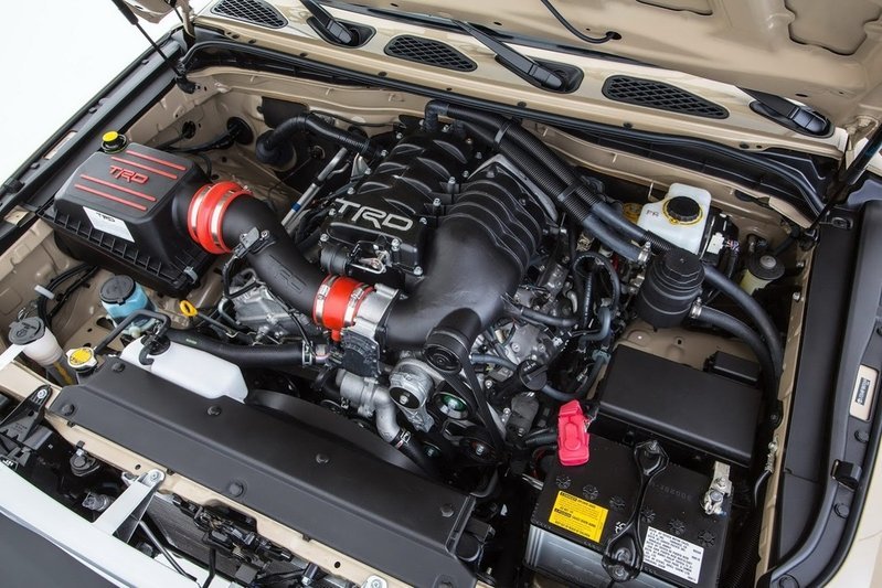

    You should go man, he wanted me to send a picture of a 3.5 ECU but if you talk to him I'm sure he'd let you drop by for R&D or maybe even a tune.

    Ive heard the same thing that there is no trd supercharger for 2016. which makes me wonder what this is...
  9. Jul 29, 2016 at 12:41 AM
    #49
    Kenjiro
    Kenjiro Well-Known Member
    May 11, 2016
    #186717
    237
    2016 DCSB TRD-OR
    That isn't a 2016 Tacoma. Wiper cowl is different, grill mounting point is different, hood lines on the fender are different. Also, washer squirters are in a different location.
  10. Jul 29, 2016 at 12:42 AM
    #50
    1st&lastTaco
    1st&lastTaco Well-Known Member
    Jul 18, 2016
    #192281
    69
    so what is it? i see quicksand & it sure looks like a 2016 3.5l. oh i see the wiper cowl is very different, am i seeing 3 wiper arms??
  11. Jul 29, 2016 at 12:44 AM
    #51
    Kenjiro
    May 11, 2016
    #186717
    237
    2016 DCSB TRD-OR
    Where did you find the picture? Looks like an FJ to me, just by the hood lines
  12. Jul 29, 2016 at 12:46 AM
    #52
    1st&lastTaco
    Jul 18, 2016
    #192281
    69
    good-ol-google
  13. Jul 29, 2016 at 12:49 AM
    #53
    Kenjiro
    May 11, 2016
    #186717
    237
    2016 DCSB TRD-OR
  14. Jul 29, 2016 at 12:51 AM
    #54
    1st&lastTaco
    Jul 18, 2016
    #192281
    69
    welp, you solved it, its an FJ, 3 wiper arms, how bout that.

    #167413
    10,284
    looks like FJ to me
    HutchJ likes this.

    Minnesota
    2016 TRD OR DCSB 4x4
    3 wipers should give that away

    Idaho transplant in WV
    16 Tundra Crewmax SR5 OR/15 Corolla S
    Doesn't actually matter what vehicle it is one thing with 99% ceranty is that it's a 4.0. Look at the oil filler neck, the 4.0 stuck out to the side the new motor turns more to the front of the truck if I'm not mistaken.

    11,966
    Toyota has discontinued all supercharger development, you will not see a TRD product that will increase horsepower. Aftermarket will come, but the programming will be the biggest challenge.
    Also that is a Dual VVTI 1GR, the oil filter is below which is why it's confusing to Tacoma guys.

    To bad that's an FJ.....
