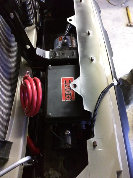

    Certainly. One thing we did was design every single vertical inch from the base of the tub to the bracket directly above the winch, behind the grille.

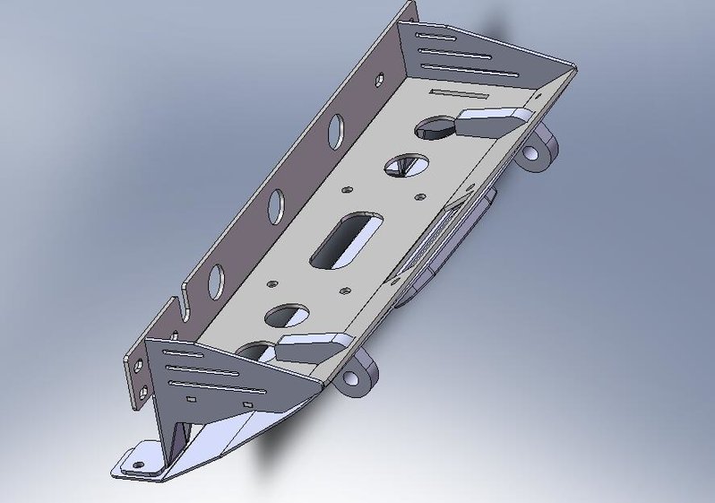

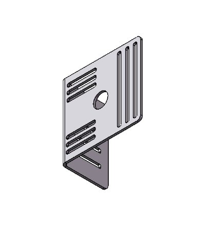

    As you can see with the attached photo and the Engo winch it's a no go for the box to fit under the bracket. The new Engos will mount center or side and some winches mount over the motor side as well (like our Mean Mother winches). However, we didn't want to create work for our customers so we created a universal box mount bracket and several slots on the end of the winch tub (second drawing) so you can mount just about any box as you wish without extending cable.

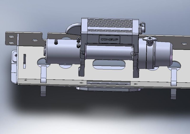

    Basically, any winch up to 12,000lbs with a standard 10" x 4.5" bolt pattern will fit. You will need to use synthetic rope as a roller fairlead will not mount up without sticking out pretty far and at an undesirable angle.
    As you can see in the third drawing there is quite a bit of room on that end of the winch tub. (ignore the ComeUp winch, it's the only one we have in CAD)
