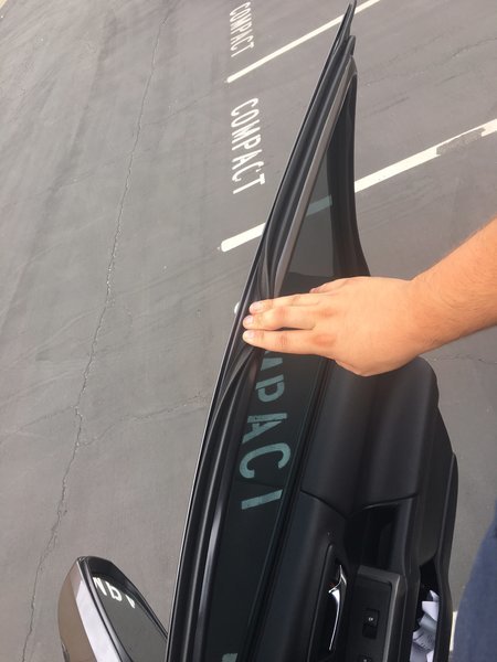

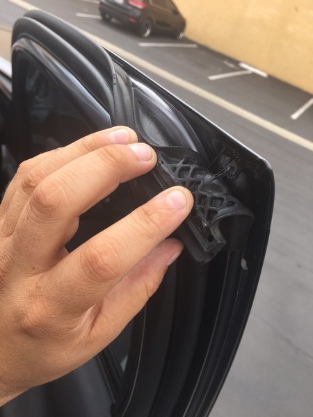

    i inserted a 3/4" OD medium hard tubing into the door (need to be soft enough to give a little but no squish flat) between the door gasket and the door metal. once i did that the sound stopped and the truck was also alot quieter inside.
    in the picture i used clear tubing so u can see the tube better and where to put it... the black rubber hose didnt show up that well but worked the best (the ID for the black tube is roughly 1/2")

    Mine is in the shop right now for the same problem. Supposedly they have new, updated door/window seals. Call your local dealership and they'll replace it for free.

    Same. mines in the shop. They said theres not technically a TSB out for it, but when they ordered new doors for a tacoma, it came with new seals which apparently fix it, so if they order new seals, they'll be the new updated ones that fix it. Warrantied as well.

    I have a 2017 DCSB and wanted it to be slightly quieter. Upon inspecting my door seals and body side seals I noticed some flimsy bits and when you pull on the door side it easily comes away from the door. They are just held on by clips spaced about a foot apart.
    What I did to fix it was use weatherproof foam weatherstripping (black) from Home Depot. I sealed up the front edge and just reinforced the flimsy bits on all 4 doors. What a huge improvement. Between fixing the LCA whistle and sealing up the doors the truck is now as I would expect it to be. (I am slightly OCD about wind noise and whistling)
