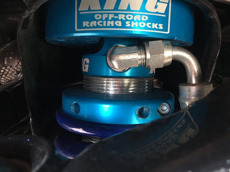

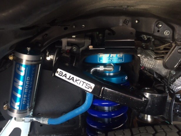

    In a debacle, and wanted to see what some of you guys would do. I am running Kings 2.5 all around and dakar leaf pack with an extra AAL to support the topper, roof rack, and all the camping equipment. It seems that the extra AAL was too much since the truck is still raked like crazy even after fully loading with all camping gear, fridge, icechest, etc. Ive also had it on for two weeks, so I think they should be fully settled in. Picture below of before and after the Dakars and AAL were installed.
    Should I remove the AAL or remove one of the overload springs?
    Or should I just crank up the front coils a little to match? This is currently how the front coils look, looks like I can crank them up a little more, but am worried about offroad reliability. Below is pic:
    Any advice is appreciated. Thanks in advance!

    Have you done any fender lip to rim measurements? I don't think you have much lift in the front over factory. Dakars will definitely lift over stock, a couple of inches typically, but your Kings are adjustable and maybe they are set to stock height or not much lift. The spring collar does seem pretty high up on the body, but I don't know enough about King C/O to know if that's right or what the setting means.

    rear looks much higher, but front not so much. not too familiar with kings, but looks like they are on about the lowest setting. thats where id start

    If I was a betting man I'd say you have all that 3" max lift still left, maybe more like 3.5", to go. If you're happy with the stance in the back you should be able to get the front to the same level. Probably only take about 2" or 2.5" to get there and your CV joints will be fine. The issue you /may/ run into would be upper control arm angles and alignment.

    Kings, Pelfreybilt skids, mobtown sliders, dakars, SCS
    I was thinking the same thing too. It just looks too low. I would be happy with just one more inch up front since I still want some rake.

    I have a similar set up, tuned professionally, my truck doubles as a chace vehicle in the SCORE races. If you crank up the coils do not go over 8 threads showing at the top. That would be the maximum you want to be to stay within the optimal performance of the shocks. If you add a fab front bumper or additional accesories you will need to revisit the internal set up of your shocks. Hope that helps.

    Looks like I can crank it up 2-3 more coils to be safe? And it looks like both sides aren't even even.
