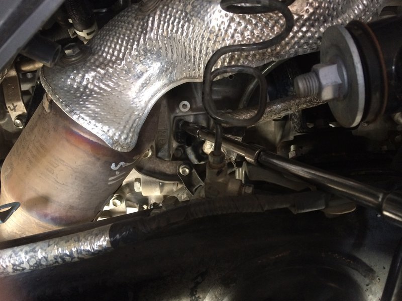

    Here's the location. You can see it's right next to the exhaust, so not someplace you want to be working when the engine in hot.

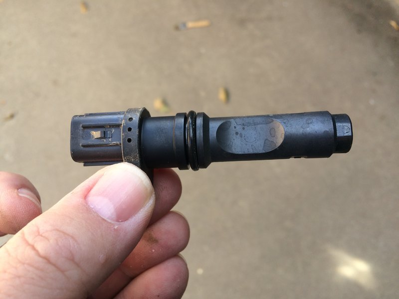

    Here's the sensor. I find it interesting that there are clean water spots on the "inside" portion of the sensor, while the outside has dirty water spots (as expected for my operating history).

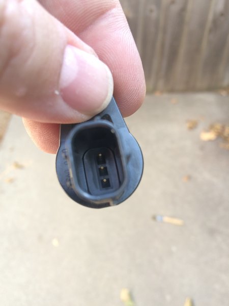

    And here's a shot showing I do NOT have the hashed circle that indicates the newer sensor production.
