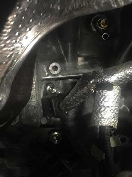

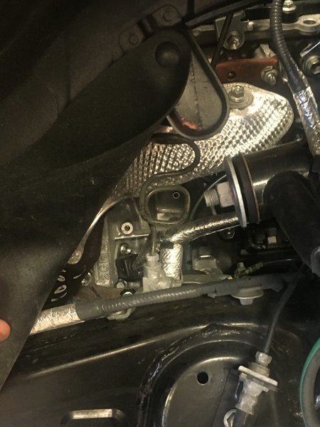

    For those wondering just what they're looking for on a vehicle.. Courtesy of the first vehicle I'm working on today. (Just a 10k service)
    I'd have pulled the connector off, but the manifold is right there and I burnt my had on the first attempt. The big rubber boot covering the connector doesn't help things. Do it when the engine is cold!
