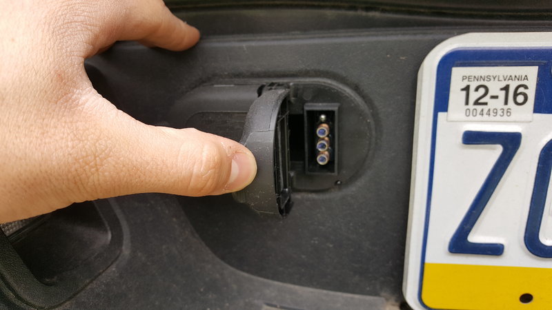

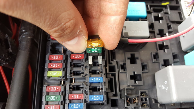

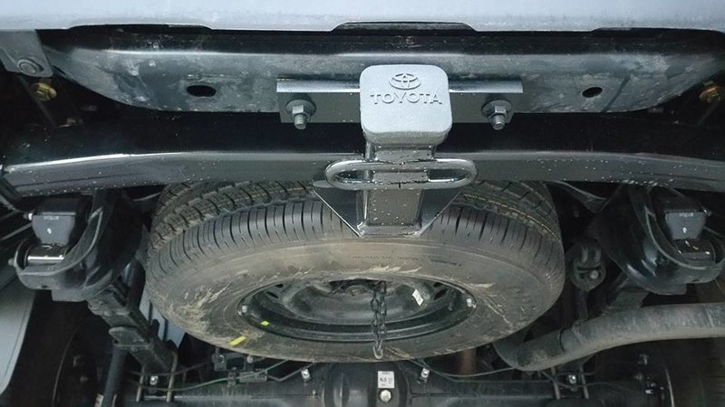

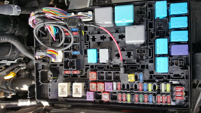

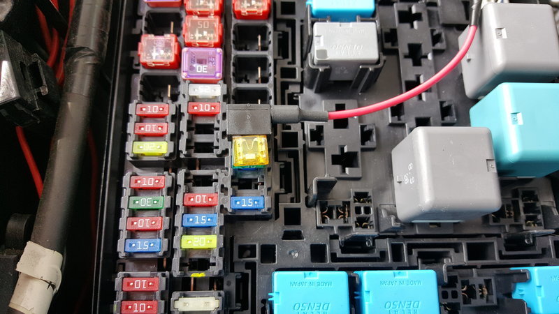

    I just installed mine Friday and it works fantastic, also purchased a in line Fuse holder and ran the 12v right into the Fuse box and hooked it up the the 30 amp trailer Fuse that's already there, and added the truck 20 amp for the harness. It makes it cleaner than going to the battery!
    Here are some pictures:
    20160515_120121.jpg 20160515_120054.jpg 20160515_120112.jpg 20160515_120211.jpg 20160515_120215.jpg 20160515_120220.jpg
    Caliph420[OP] likes this.

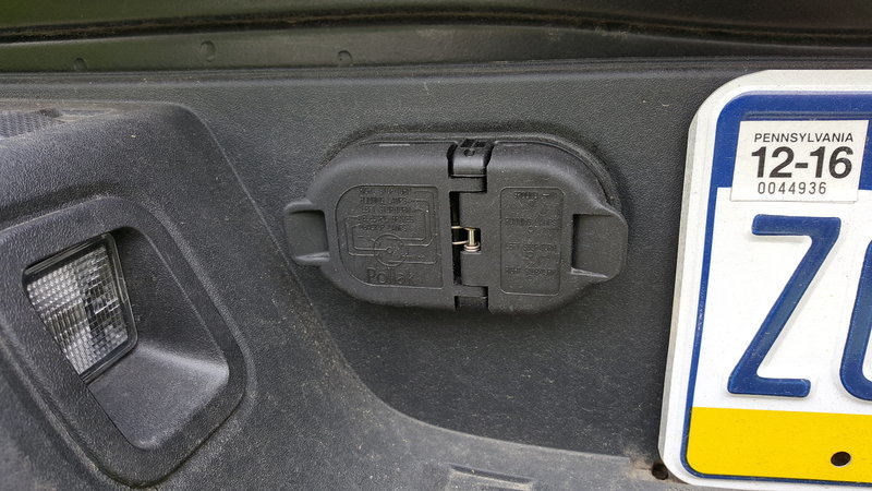

    Yep cut the 4 pin off and just wired it to the 4 and 7

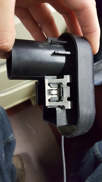

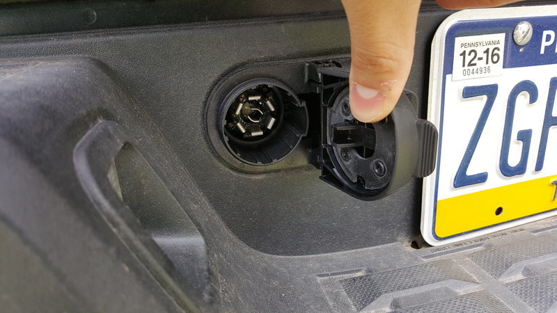

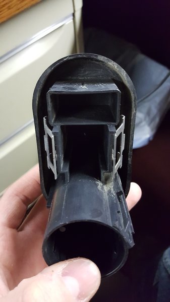

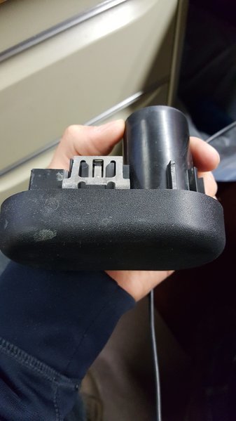

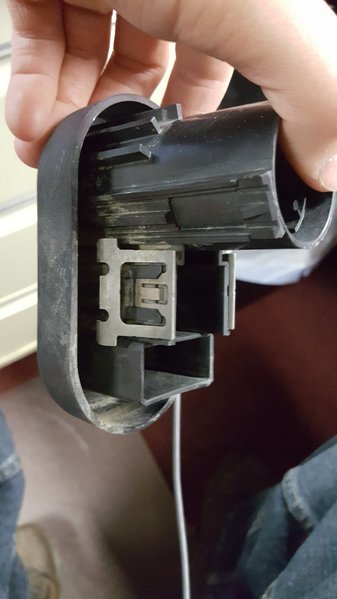

    Yep, from behind there are 2 clips you squeeze and that blank just pops right off!!!
    Here is few pictures of the blank Toyota uses for that spot!
    And here is the link to the trailer wiring harness and the 4-7 pin connector!
    https://www.etrailer.com/Wiring/Hopkins/HM40975-11998.html
    https://www.etrailer.com/Custom-Fit-Vehicle-Wiring/Curt/C56282.html
