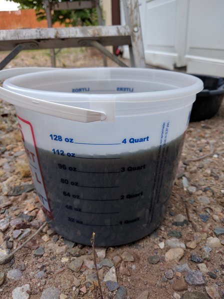

    This might somehow be related, so I'll post it anyway. Just changed my rear diff fluid, and as suspected I was low. About half a quart low, maybe even more. Replaced with redline 75w85 synthetic. I can already feel the truck shifts smoother. I have the off-road so my diff takes 4 qts. Which it took exactly that before fluid started to trickle out. WTF Toyota

    Glad you got that switched out!

    Thanks man. I think everyone should check their levels in diffs. Just like the trans fluid Toyota dropped the ball on topping off other crucial fluid levels
