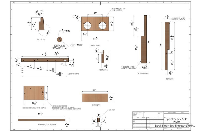

    Yeah they didn't come out all that clear. I will see if I can get a better conversion.

  3. Mar 9, 2016 at 11:34 AM
    #63
    garyinok
    garyinok [OP] Well-Known Member
    Oct 15, 2015
    #166720
    99
    Gary

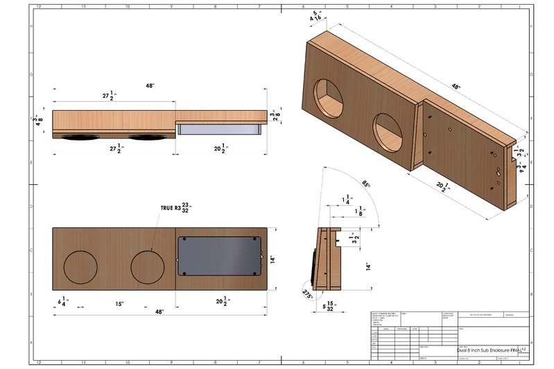

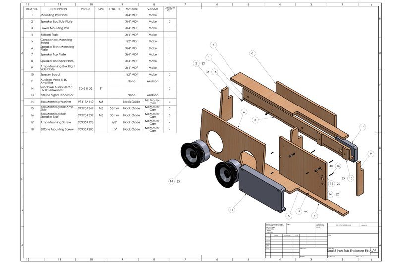

    OK lets try these. I increased the font and added the plates.

    I am getting a lot of PM's telling me the jpeg's of these are hard to make out. I have finally cleaned these up and deleted off the stuff specific to my particular setup. If anybody is interested in the prints send me a PM with an email and I would be happy to share them.
