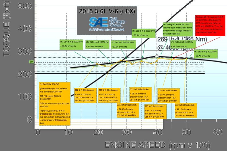

    For a shitty point of comparison, here is some crayon analysis...
    Cliff notes: I took @Redbuskets dyno, normalized it with a +31 lb-ft correction (his max of 234 is 31 less than spec'd max of 265) for drivetrain loss, and overlaid it on a SAE crank plot for GM's V6. Here we go....
    The above is a rough dyno plot of GM's LFX 3.6L V6 from SAE. Note this is from the crank. Now, let's use some MS Office magic for a ballpark look (this is by no means, at all conclusive or exact) to get some perspective.
    The comparison is based primarily on percentage (%) available torque at an RPM compared to the max torque measured (in this case, also specified). Because we are comparing percentage torque available, not pure numbers, it should be a reasonably valid comparison. The overlay of actual torque numbers is not valid and for ballpark comparison only. Caveats: I have no idea what the margin of error is, and this bench plot is nowhere near as detailed as @Redbuskets dyno.
    I put the 2GR's % results from @Redbusket's dyno plot on the graph in Orange for comparison. Here's a messier look on how I slapped the two graphs over one another.
    Edit: to add a conclusion here, all it indicates is that the torque rolloff profile of the 2GR is comparable to the LFX. Doesn't look bad at all. People complaining about weak power? I say blame the Auto tranny and Toyota's nonlinear throttle control.

    You can bet that the GM data has been smoothed and averaged and is not the actual measurement. The actual measurements would have variations in them as the yellow line does. So the only meaningful information you can draw from that, is that the GM engine has a similar rolloff on both sides of the torque peak.

    Yeah, pretty much all I take from it is that the 2GR is *probably* in the ballpark for torque in the lower power band, minus the high ~3k hiccup. I think it means it may be a decent result. Certainly not scientific or solid conclusions, as you say.

    To clarify, I think this is interesting based on all the anecdotal "no low end power" bellyaching.

    I think you're right. As I've said before, I think the "no low end" complaints have more to do with the DBW throttle programming, not the power output of the engine itself. If you put your foot in it, it goes. If you gently squeeze the throttle, it makes sure you're serious about it before it starts adding a meaningful amount of fuel and air.
