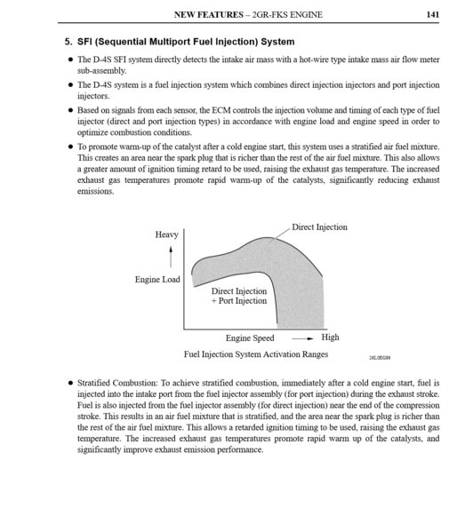

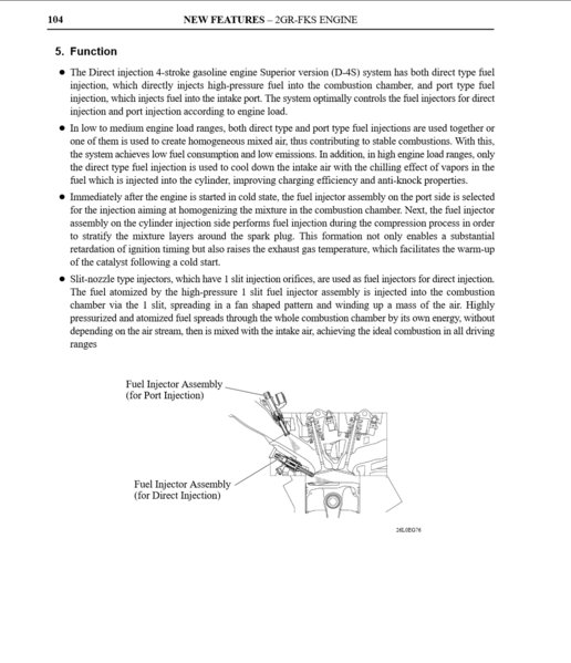

  8. Jan 21, 2016 at 3:17 PM
    #368
    StAndrew
    StAndrew Wait for it...
    Feb 8, 2010
    #30950
    8,390
    Hampton Roads, Va
    SR5 4x4TRD
    Intake, exhaust, lift. Typical stuff.

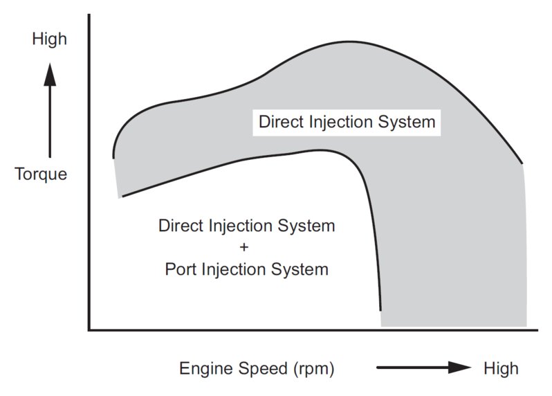

    @Tharris242 For what I'm assuming is the .pdf you are referring too:
    Says nothing about throttle position. The dip is from the transition from sequential port/direct injection to direct injection.
  9. Jan 21, 2016 at 3:28 PM
    #369
    StAndrew
    Feb 8, 2010
    #30950
    8,390
    Hampton Roads, Va
    SR5 4x4TRD
    Oh, you've proven my point before me. Its settled then.
  10. Jan 21, 2016 at 3:28 PM
    #370
    Tharris242
    Tharris242 Technically
    Jul 30, 2015
    #160687
    482
    Houston, TX
    2017 TRDOR DCSB 4X4 A/T FP TO BL
    Solid Fold 2.0, Air Dam
    C'mon... full throttle=high load. It says right there... high load = DI only. The dyno is max load; so, DI only - no transition.
    Yes, everything I have read here says dip is transition; but, that appears to be speculation based misunderstanding.

    Throttle position and engine load are two different things. The only time DI would be used exclusively in that graph is if you are hauling/towing a heavy load. I don't think a dyno is considered a "heavy load"
