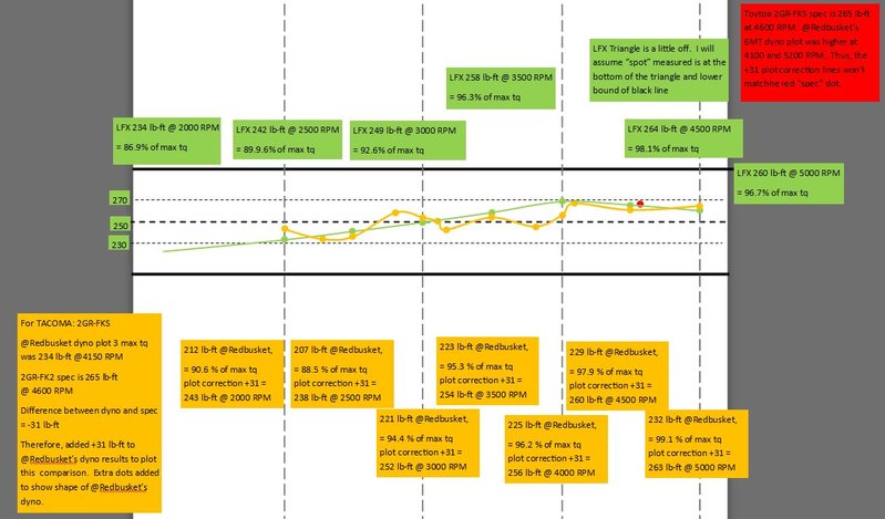

    Random mathlete time. Based on the SAE LFX dyno (smoothed and vague) versus my crayon normalization above, comparing the Colorado (4wd CrewCab V6 Shortbox AT) at 4380 lbs and the Taco (DCab V6 Shortbed AT) at 4480 lbs ....fudged numberwang tell us this...
    Average curb weight pounds per lb-ft of torque measured (2,000 to 5,000 RPM)
    Colorado (4380 lbs/253.7 lb-ft avg): 17.26 lbs per lb-ft
    Tacoma: (4480 lbs/252.3 lb-ft avg): 17.76 lbs per lb-ft
    That's a -2.8% average torque difference. Between 2-3K RPM it was a -1.1% difference in Chevy's favor, but note the 2GR had some wild swings down there on @Redbusket 's dyno. The 2GR was down ~6.9% in power to the LFX at exactly 4000 RPM, but that gap is much narrower above and below peak (everywhere else). Also of note: 3.5L vs 3.6L is a -2.77% difference in literage. Now taking engine size and that 0.1L difference into account...
    At max torque:
    LFX (269 lb-ft/3.6L): makes 74.72 lb-ft per liter
    2GR-FKS (265 lb-ft/3.5L): makes 75.72 lb-ft per liter.
    For average measured torque:
    LFX (253.7 lb-ft/3.6L): makes 70.47 lb-ft per liter
    2GR-FKS (252.3 lb-ft/3.5L): makes 72.08 lb-ft per liter
    That's a +2.2% difference in the 2GR's favor. Harrummph I say.
    TL;DR: The 2GR is probably decent for power; within the ballpark at least even calculating for weight, and yes even under 3k RPM. Blame your fat Taco and the auto transmission for your butt dyno issues.
    Edits: added some maths, fixed some maths. Note: I just wanted to say "fat taco".
    Edit 2: I still think Toyota's Nonlinear Throttle Control logic is also partly to blame for negative butt dyno impressions.
